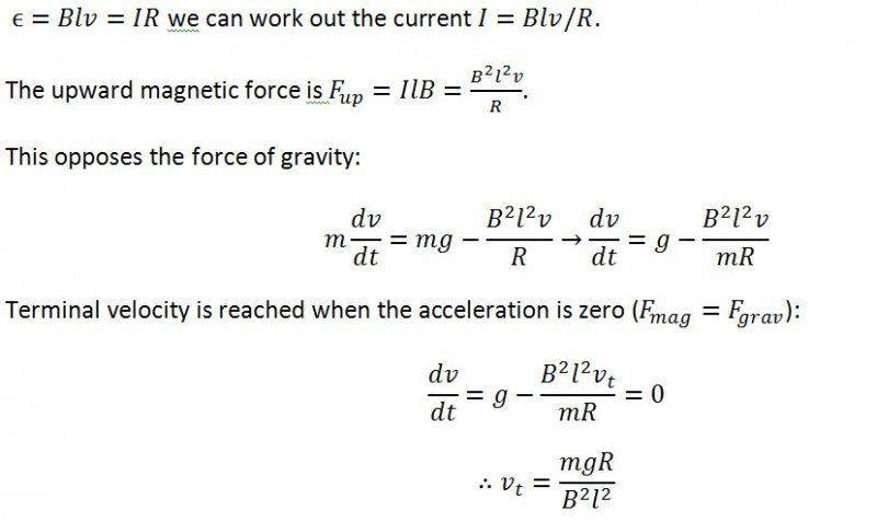

A square aluminium loop, of side a and uniform cross-section falls in a vertical plane under gravity, as shown in the diagram. A uniform, horizontal magnetic field B, indicated as the shaded area, points into the page.

(a) If the loop starts when its lower edge is coincident with the lower edge of the magnetic field, how long does it take to clear the field?
(b) We were careful to avoid starting the loop from above the shaded area. Why?

In the attachment I have already worked out the equation for acceleration, velocity, and terminal velocity.
(a) If I understand correctly, the distance to be traveled in order to clear the magnetic field is ##a## (side length of the square loop).
So since the loop is fully immersed in the magnetic field, it would just accelerate at the local gravitational acceleration g (the flux through the loop would not change if it is fully inside). So
##\frac{dv}{dt} = g - \frac{B^2l^2 v}{mR} = g##​
I have used the equation ##s=\frac{1}{2} at^2## to work out the time:
##t=\sqrt{\frac{2s}{a}}=\sqrt{\frac{2(a)}{g}}##​
Is this right?
(b) I have no idea. It think the loop would simply start to fall freely with acceleration g, then its acceleration would change when it comes to the upward force exerted by the magnetic field. So why does the question avoid starting the loop from above the shaded area? :confused:
Any explanation here would be greatly appreciated.
  • Handwritten derivation: EMF = Blv = IR gives current I = Blv/R; upward magnetic force F_up = IlB = B^2 l^2 v / R; equation of motion m dv/dt = mg - B^2 l^2 v / R; terminal velocity v_t = mgR / (B^2 l^2) where acceleration is zero.
the acceleration is no longer equal to g once it is moving. So you can't use the simple SUVAT ##

Then what other equation do I have to use? I'm a bit confused, I thought it should be falling with the local gravitational acceleration g while transitioning out of the magnetic field (as the flux through the loop is not changing).
I'm not with you: if it starts, the flux is Ba2 and by the time it has fallen over a distance a, the flux is 0. How can you say the flux isn't changing ?
Your ##
\frac{dv}{dt} = g - \frac{B^2l^2 v}{mR} = g## is a differential equation for ##v##. ##v = {ds\over dt}##, so you get an expression for ##s(t)## and solve ##s(t) = a##. RIght ?

##v## in the second term is a function of t. ##{dv\over dt} = g## only at t=0. Your ##v## does not satisfy the differential equation.
Integration constants follow from initial conditions: v(0) = 0 and s(0) = 0.
So if I understand correctly, do you mean I should solve ##\frac{dv}{dt} = g- \frac{B^2l^2 v}{mR}## for finding an expression for s(t)? (I mean, instead of the other expression with g alone)

Now, you have a differential equation to solve. Something of the form$$
{dy\over dx} = g - \alpha \; y(x)$$where$$\alpha = B^2l^2/mR$$
Ever done before ?

This I don't understand. At t=0 the lower edge of the loop is at the edge of the B field area. if s = a/2, the magnetic field is B only in half the area of the loop and if s = a the loop is completely outside, so flux = 0

You are absolutely right. I thought it was moving from the top, I completely I misunderstood the problem, my bad. :oops:
I tried to find the velocity of the loop as a function of time:
##\frac{dv}{g-\frac{B^2l^2 v}{mR}} = dt \implies - \frac{mR}{B^2l^2} ln (g- \frac{B^2l^2 v}{mR}) = t + c##
Letting ##a = B^2l^2/mR## we obtain:
##\therefore g- av = e^{-a(t+c)} = e^{-at} e^{-ac} = A e^{-at}##​
Using initial condition v(0)=0 we obtain the constant A=g. Therefore:
##v(t)=\frac{ds}{dt}=\frac{g}{a} (1- e^{-a t})##
(The g/a part is just the terminal velocity, a numerical value we have already calculated)
So basically, I need to use ##s(t)=\frac{g}{a}(t+\frac{e^{-at}}{a} + c_1)## (with ##s(0)=0 \implies c_1=-1/a##) in order to find the time it takes to clear the field by substituting the length of the edge of the square?

##s(t)=\frac{g}{a} (t+ \frac{e^{-at}}{a} - \frac{1}{a})=x \implies t +\frac{e^{-at}}{a} = \frac{ax}{g}+ \frac{1}{a} ##
How can I solve that?

I don't know of a standard way to solve this kind of equation (other than numerically).
If you have a numerical value for ##v_t## you also have one for a. Perhaps ##a t## is small enough to use a power series approximation for the exponent ?
[edit] Griffiths 3rd ed. exercise 7.11 makes life easier for itself by asking when v is 90% of vt -- so a simpler equation results. (Solution here)

This can only be done numerically (or graphically). Do you have numerical values for all the quantities? You can also try to Taylor expand ##e^{kt}## to second order, solve for t and check if the expansion was valid (i.e. if indeed ##kt \ll 1##).

Thanks @nrqed, I did have numerical values and eventually solved it numerically.
