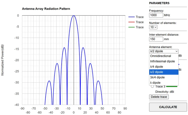

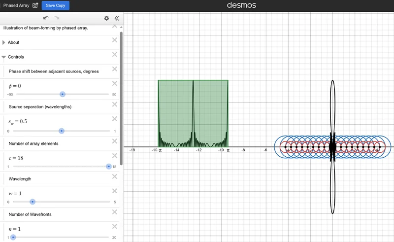

Perhaps you can gain intuition regarding the kind of beams that can be formed from a phased array of antennas by playing with on-line calculators. For example, here's one that allows you to adjust the number of antenna elements, their spacing and relative phase shifts:
https://www.desmos.com/calculator/ ahcf6sjs7z
Here's another that lets you choose the specific type of the individual antennas:
https://antennaarraycalculator.blogspot.com/p/calculator.html
But do bear in mind that these calculators model a linear (1D) ##n##-element array of antennas. If you desire a beam that is narrow in both transverse directions, you require a 2D rectangular array of ##n^2## elements. That amounts to 100 antennas for the second case above and a whopping 324 in the first!
