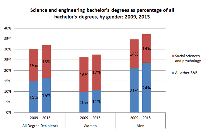

Tiger Blood said:
Today people are really declining to study natural sciences but rather choose to study economy and management, science is fun to see on internet, but not something serious.
Which country are you talking about? In the United States adoption of Science and Engineering has risen in recent times. Just look at this graph from the National Student Clearinghouse Research Centre
Tiger Blood said:
So if there are more and more people pursuing careers in nuclear physics there will be more and more people working on it's development. I mean today shows like "The Big Bang Theory" are responsible for slight rise in people pursuing science careers and it's sad that in this day of age people are not interested more, but if there is to be proliferation of nuclear fusion plants all around then it's going to be very motivational for people.
I really doubt that show has had more than a negligible effect. Do you know of any studies that have reported it as a determinator for degree choice? Also whilst it's logical that more fusion reactors would create more fusion jobs and could encourage more people to take up the degree we've still got to actually get the fusion research done. That's no guarantee. We could equally invest in fission research which we know could work now.

  • #60
Yeah I'm talking about US (and other countries are not far). What you didn't watch "Capitalism: A Love Story"?! Here you have to scroll to 1h.02m.30s so that Professor William Black explains it to you
