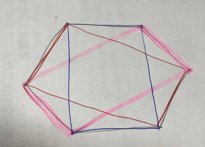

Did I take it wrong ?
Sorry, I read it as no two adjacent vertices. In my defence, I was influenced by the OP's attempt, which seems to have made the same mistake.
Fwiw, I now get 0, 3, 7, 38 for n=5, 6, 7, 8.

You read it correct.
But it says "adjacent sides". For two adjacent sides to be part of the quadrilateral it would have to use three consecutive vertices, not just two. See the diagram in post #4.
Doesn't "no adjacent sides" imply you cannot have adjacent vertices? Diagram in 4 has these, and so is not the description I am looking for.
Example: vertices v1, v2, v3, v4, v5, v6, v7, v8, implies v1,v3,v5,v7 and v2,v4,v6,v8 are the only two solutions, since none of these quadrilateral sides are adjacent with the octogon.
No. Look at e.g. the pink triangle in post #4. It uses two sides of the hexagon, but they are not adjacent in it.
