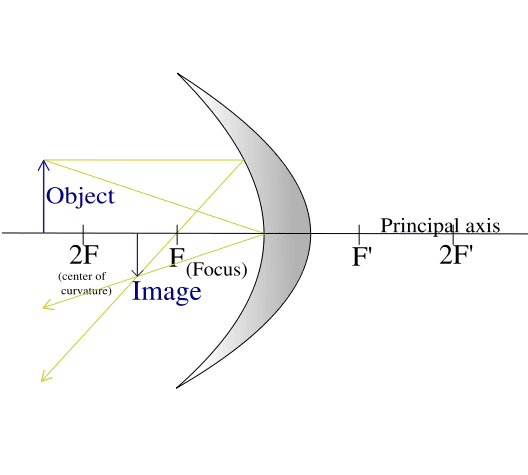

Sorry, swap "convex" with "concave". You must be familiar with these diagrams of geometric optics:
This is a single shield. The sun is the "object". The image is where light is concentrated.
If the sun was a point source, the image would be a point too. A single shield could burn a point on the sail and possibly start a fire.
But the sun is not a point source and each shield is flat. So the image of the sun is behind the flat mirror, at a distance equal to the distance to the sun. It's like a window to a 2nd sun.
Each shield, makes an image of the sun behind it. When enough sun images are created behind shields, and they can all be seen from an observer on the boat, the boat burns.

You are getting there- you are correct, the illumination at the focus (for the Archimedes legend) is an image of the sun.
Question- How large is this image? What is the brightness of this image, relative to the brightness of the sun? A hint is that the 'raw' sun is an object subtending 32 minutes of arc. Another hint- instead of thinking in terms of the light going into the optical system, stand on the ship and think about the light coming at you.
Edit: 'brightness' is a photometric term, it should be 'radiance', which is the corresponding radiometric term.
