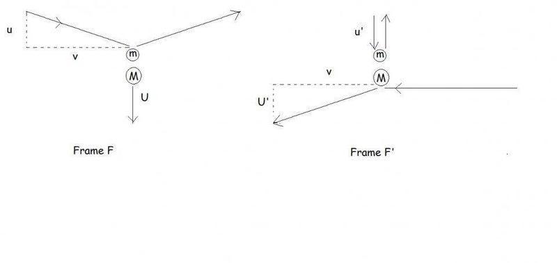

I'm not sure if it's more or less intuitive than the mathematical proof that assumes energy and momentum are part of a Lorentz 4-vector, but you can give a hand-wavy argument for the relativistic form of momentum and energy by considering collisions, conservation in multiple frames, and the nonrelativistic limit (where the forms for momentum and kinetic energy should reduce to the Newtonian expressions).
You can first establish that spatial momentum is given by \vec{p} = m \gamma \vec{v} (where \gamma = \frac{1}{\sqrt{1-\frac{v^2}{c^2}}}) It is basically the only choice that reduces to Newtonian momentum in the nonrelativistic limit and which, if it is conserved in one frame, then it is conserved in every frame.
Then, you can try the guess that the energy of a free particle has the form E(v) = g(v) m for some unknown function g(v), which depends on the magnitude of velocity (but not the direction). Now, consider a completely inelastic collision in which two wads of "gum" of mass m that collide and form a larger wad of mass M.
Let F be the center-of-mass frame. In this frame, the initial velocity of one wad is +v (let it be in the x-direction), and the initial velocity of the other wad is -v. Afterward, the larger mass M that results is stationary. Conservation of energy gives:
2 g(v) m = M g(0)
Let F' be a frame that is moving at speed -u in the x-direction, relative to F. Assume that u \ll v. In this new frame, one wad is traveling at speed v' \gt v, and has momentum p' = + m \gamma' v'. The other wad is traveling at speed v'' \lt v, and has momentum p'' = - m \gamma'' v'', where \gamma' = \frac{1}{\sqrt{1 - \frac{v'^2}{c^2}}} and \gamma'' = \frac{1}{\sqrt{1 - \frac{v''^2}{c^2}}}
Now, using the relativistic velocity addition formula and some slightly tedious algebra, you can show, to first order in u, that:
p' \approx \gamma m v + \gamma m u
p'' \approx - (\gamma m v - \gamma m u)
So the total momentum in this frame, before the collision is:
p_{total} = 2 \gamma m u
After the collision, the big wad of mass M is just moving at speed u, which we assumed was very small, so we can use a nonrelativistic approximation: p = M u.
So conservation of momentum in this frame gives:
2 \gamma m u = M u \Rightarrow M = 2 \gamma m
Now, plugging this back into our equation for conservation of energy in the original frame gives:
2 m g(v) = M g(0) \Rightarrow 2 m g(v) = 2 \gamma m g(0)
So we conclude that g(v) = \gamma g(0)
At this point, we compute the form of kinetic energy for low velocity:
K(v) = E(v) - E(0) = m g(v) - mg(0) = m \gamma g(0) - m g(0)
We can use a Taylor series to write \gamma = \frac{1}{\sqrt{1-\frac{v^2}{c^2}}} \approx 1 + \frac{1}{2} \frac{v^2}{c^2} + terms of order v^4/c^4. So to lowest order,
K(v) \approx m g(0) \frac{1}{2} \frac{v^2}{c^2}
Comparing with the Newtonian limit, K(v) = \frac{1}{2} m v^2, tells us that g(0) = c^2
So that tells us the complete form for relativistic energy is E(v) = m g(v) = m \gamma g(0) = m \gamma c^2
Note that the assumption that energy depends only on mass and velocity is kind of bold. In classical physics, that's only true if you ignore "internal energy" such as heat.
2 g(v) m = M g(0)
Wait a moment, what happens if i insist that g(0) = 0 ?
Then this equation does not make any sense, unless g(v) = 0 which is trivial solution.
Should there be then some additional energy after the collision in the forms of photons, some other particles, potential energy etc such that:
E_{something else} = 2 g(v) m
and total momentum:
p_{something else} = 0
to make the larger mass stationary? or is it just impossible possibility that g(0) = 0 ?
2 g(v) m = M g(0)
That doesn't sound consistent to me. The left-hand side is nonzero.
The three equations that I have for this collision are:
  1. 2 g(v) m = M g(0) (from energy conservation in the COM frame)
  2. 2 \gamma m = M (from momentum conservation in another frame)
  3. m (g(v) - g(0)) = \frac{1}{2} v^2 + higher-order terms (from nonrelativistic limit)
That's why I conclude g(0) \neq 0.
and total momentum:
As I said in the post, the argument assumes that energy is proportional to mass, and works out the proportionality. That's actually a pretty strong assumption, because in nonrelativistic physics, it's only true for particles with no internal energy.
On the other hand, it's possible it's just a matter of definition. If you want to allow internal energy, then that internal energy will be associated with a "pseudo-mass", that will also have momentum.

Could you show that E:=g(v)·m is allowed in special relativity if we wouldn't know that the result is correct?
My derivation (I skipped the derivation for momentum, but it's not that different) starts off assuming that in relativistic collisions of point-particles (no interactions other than collisions), that there are two conserved additive quantities: A momentum, which is assumed to be a velocity dependent vector quantity in the same direction as the velocity and proportional to mass, and an energy, which is assumed to be a velocity dependent scalar quantity, also proportional to mass. (Of course vector and scalar here mean 3-vector and 3-scalar, not 4-vector and 4-scalar). Then you demand that the laws governing such collisions be invariant under rotations and translations and Lorentz transformations.
Why make these assumptions? As far as my derivation, it's just a guess, inspired by the corresponding facts about (elastic) collisions in Newtonian physics, where the momentum is given by: \vec{p}(v) = m \vec{v} and the energy is given by: E(v) = \frac{1}{2} m v^2. As I noted in my derivation, in the Newtonian case, the energy E(v) is only conserved for elastic collisions (you can fix this by allowing internal heat energy, but this energy is not assumed to be proportional to mass), so I agree that it's a little unmotivated to assume that the E(v) is conserved, even in inelastic collisions.
stevendaryl said:
No, the guess that E(v) = g(v) m is true classically, as well: In that case, g(v) = \frac{1}{2} v^2
No, it isn't. In classical mechanics your calculation results in g(v) = g(0). With g(v) = v²/2 you would get E = m·v² = M·0²/2 = 0 in the rest system of the center of mass which makes no sense either. Considering the change of internal energy during the inelastic collision wouldn't solve that problem.
In classical mechanics the same assumptions fail in combination with E=g(v)·m. What makes you sure that they work in special relativity?
Don't get me wrong. The result shows that your initial assumption make sense and I can explain why it doesn't work in classical mechanics. But how could we show that without the knowledge of the correct result?
So this derivation is valid when g(0) is not 0
