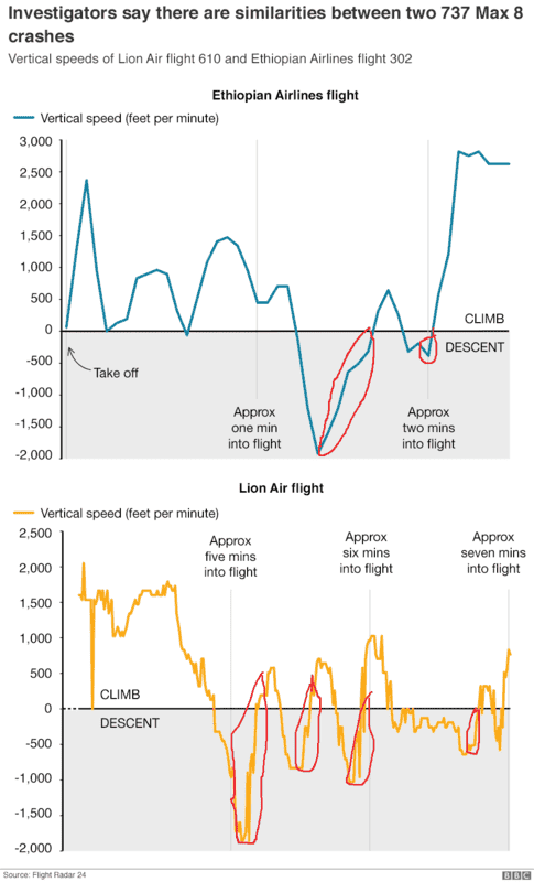

PeterDonis said:
If the primary purpose of MCAS were to "change the aerodynamics of the plane" (which I think is a misleading way of looking at it anyway) and force the nose down, it would function more like automatic stall prevention in a fly-by-wire system: if it detected that the plane was too close to a stall, it would simply override the pilot's input and use the yoke control system to force the nose down--i.e., it would force the yoke to a different position than the pilot wants to put it. But it doesn't do that.
When we look at the data we have, the MCAS system or the automatic stall prevention, whichever, engaged 26 times with nose down maneuvers in the Lion Air case, before crash the FDR showed the pilots exerting 100lbs of force to pitch up. Even if the system is not overriding consistently like in fly-by-wire. It's reengaging often enough after the pilots try to override with manual force over and over again, enough to might as well be considered "overriding".
Also, simply because MCAS adjusts trim via the a horizontal stabilizer, I would contend it doesn't make it less dangerous or flight critical than if it took the yoke control and adjusted only the elevators of the stabilizer.

still some dots left unconnected for me.
https://www.boeing.com/commercial/737max/737-max-update.page said:
A pitch augmentation control law (MCAS) was implemented on the 737 MAX to improve aircraft handling characteristics and decrease pitch-up tendency at elevated angles of attack. It was put through flight testing as part of the certification process prior to the airplane entering service. MCAS does not control the airplane in normal flight; it improves the behavior of the airplane in a non-normal part of the operating envelope.
and i question this statement
Pilot has to deactivate MACS or satisfy it that plane is where MACS wants it, else they''ll get in a tug of war.
I can wait. These disasters are always like a row of dominoes stacked up . Done enough troubleshooting to know that the apparent conflicts don't resolve until you arrive at complete understanding.

If you don't do anything with the yoke to keep it at neutral, yes. But you can stop the pitching down by applying force to the yoke. And because the purpose of the yoke is to command a particular pitch attitude, whereas the purpose of the trim system is not, any actual pilot, if he wants to pitch the nose down, is going to push on the yoke, not apply nose down trim. The nose down trim will come later, if the pilot decides he wants to maintain a different pitch attitude/angle of attack for an extended period of time.
You've stated before consistently MCAS does not pitch the nose of the aircraft down. I completely disagree. It adjusts trim, which is not primarily used by the pilot to change pitch, but it does effect the final pitch. As in my example, you've agreed, yes adding pitch down trim will push the nose of the aircraft down. I was not in anyway suggesting using trim is standard procedure to effect pitch attitude, not sure where you got that. I'm pointing out that trim can and does change the aerodynamics of the plane and effects pitch and can push the nose down. It has nothing whatsoever to do with pilots yoke control. If MCAS fails and sends repeating nose down trim commands and the pilot doesn't touch the yoke, the plane is going to pitch down. I feel you're finding some odd semantic way out of that argument, like "ya but the pilot should counteract with elevator control on the yoke", sure but that doesn't change that trim is pushing the nose down. It's very possible and I'd argue likely in the Lion Air situation that the repeated MCAS commands could add so much nose down trim that the column forces would be impossible to counteract.
Again, I'm asserting MCAS and trim adjustments on the stab DO pitch the nose down. You deny this for some reason.
PeterDonis said:
This makes no sense; changing the trim will change the force the pilot feels on the yoke. For example, in your scenario where the yoke is at neutral and trim is zero, if nose down trim is applied, there will be a force on the yoke that pushes it forward. The pilot will have to apply a counter force, pulling back on the yoke, if he wants to keep it at neutral. There is no way to apply a force vector to the plane itself through the horizontal stabilizer without applying it to the yoke, because the yoke is mechanically connected to the horizontal stabilizer. And of course the yoke also applies a force vector to the plane itself, through the horizontal stabilizer.
No it does make sense. Changing the trim works in this order: it changes the trim, the horizontal stabilizer airfoil is changed, the aerodynamics of the plane have changed and the lift vector on the tail, the yoke feels these changes. There is no primary direct pathway from the trim to the yoke first. The trim operates on the trim. I don't know how you you see it as the trim operates on the yoke. Especially in our example of a 747 (perhaps it's different in a simpler craft), the yoke is hydraulic for one so I doubt MCAS is directly effecting the yoke in some direct pathway before the horizontal stab. Two, the yoke controls the elevator, NOT the entire horizontal stabilizer, which MCAS does.
PeterDonis said:
Who ever said it was the other way around? Nobody has claimed that the force feedback the pilot feels on the yoke causes the horizontal stabilizer to move.
This was in response to when you stated in response to my previous post where you said I had it backwards.
PeterDonis said:
This statement is correct. It would be possible to introduce force feedback that was not associated with any change in the aerodynamics of the plane, but that is not what MCAS, or more generally the 737 trim system, does.
You seem to be contradicting yourself here. If I'm not mistaken you've stated clearly that you believe that MCAS does not pitch the nose of the plane down and that it only effects column forces and if the pilot does not counter them with the yoke then it will pitch down. I've provided pretty ample evidence that the primary role of MCAS is to literally pitch the nose down via horizontal stab movement.
