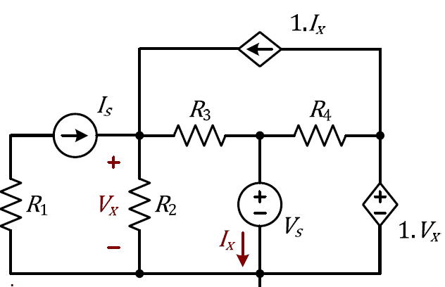

Homework Statement:: R1 = 2kOHms; R2 = 2kOHms; R3 = 3kOHms;
R4 = 3kOHms; VS = 25V; IS = 10mA
[5,5] a) Determine the power
provided by the source dependent on
current using method
of the nodes
[3.0] b) What is the value of electrical power
dissipated in all resistors in the circuit?
Relevant Equations:: V=IR
P=VI
I am currently applying nodemethod but I got to the Ix part and I don't know what is the R of Ix now how to find it.
Can you give me some sugestions please?

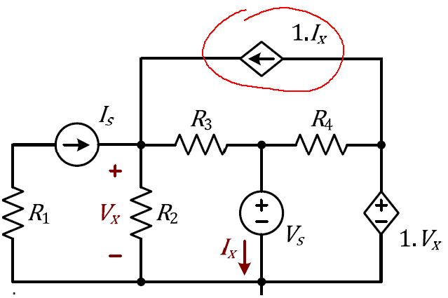

An ideal voltage source maintains voltage, independent of current. Rv = dv/di = 0.
An ideal current source maintains current, independent of voltage. Ri = dv/di = ∞.

Just to be clear, you are looking for the power produced by the indicated current source?
I am looking or the current Ix and the afte geting it and vx I will look for the power
If the object is to find the power produced by that dependent current source, then there may be an easier way to find it than analyzing the whole circuit to find ##V_x## and ##I_x##.
By inspection of the circuit, what must be the potential difference across that current source? Hint: look at the node potentials where it connects.
