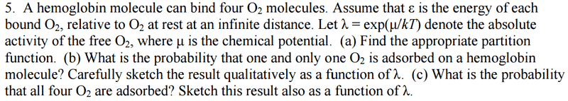

Printed homework problem 5 on hemoglobin binding four O2 molecules, asking for the partition function, the probability of one and of four bound O2, and sketches as functions of lambda.
I have question for (a) section.
I have two answer for the question but I can't figure out which one is right.
(1)Since the partition function is to sum up all the state in the system, I write down the answer
Equation for a partition function Z equals e to the power of negative 4 beta mu, times the quantity 1 plus e to the power of negative beta epsilon, plus e to the power of negative 2 beta epsilon, plus e to the power of negative 3 beta epsilon, plus e to the power of negative 4 beta epsilon.
(2)In other point of view, we can first find out the partition function of one O2 molecule.
Equation: Z1 = e^(-βμ) + e^(-β(μ+ε)), a two-term partition function sum for a single site.
(either bound or unbound)
And then, since a hemoglobin can only bind four O2 molecules, I can write down
Equation Z = [Z1]^4 = [e^(-βμ) + e^(-β(μ+ε))]^4 showing the partition function of four binding sites written in terms of Boltzmann factors.
In my opinion, I think the first solution is more accurate since I include all the situation of that system. However, I cannot persuade myself that the second solution is wrong.(Or the reason is that Z=[Z1]N can only apply to large system?)
Please help me out~ Thanks!
In (1), you have neglected the multiplicity. How many ways are there of binding 1 of 4 molecules? How many for 2? 3? 4?
What do you mean?
My perspective is that a hemoglobin can bind at most 4 O2 molecules.Therefore, first possibility is that a hemoglobin binds one O2 molecules and second possibility is that a hemoglobin binds two O2 and so on... Moreover, since O2 molecules are identical and indistinguishable (am I right?), I write down the first solution.
OK, reading the question again, I don't think it's saying there are four O2 molecules (bound or free) in the system, rather that the hemoglobin molecule has four oxygen binding sites, and the question is how many are filled (i.e. we are looking for the partition function of the hemoglobin, not the oxygen). We must assume there is an excess of oxygen, so that whether an oxygen molecule binds to a site is independent of whether the other sites are already filled. We than ask: how many ways are there of filling exactly one site? or two...?
(If we look for the PF of 4 oxygen molecules, with the equations you have written, the probabilities in (b) and (c) would be independent of λ.)
