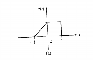

here is list of Fourier transforms:
http://uspas.fnal.gov/materials/11ODU/FourierTransformPairs.pdf
so I know the solution but I don't know how to get it. Here is what I think to do: the ramp function r(t) and the rect pτ(t). I know that r(t) is the integral of step u(t) which is integral of d(t), and I know the transform of u(t)..would that help? I guess I'm not really sure what to do. In the solution they use integral of pτ(t) minus delta function d(t)..not sure why.

You're given a graphical representation of x(t), and you want to find the Fourier transform
$$X(\omega) = \frac{1}{\sqrt{2\pi}}\int_{-\infty}^\infty x(t) e^{-i\omega t}\,dt.$$ To evaluate the integral, you're going to need to figure out what to plug in for x(t). Start there.

well i could say x(t) is X+1 from -1<x<0 and 1 from 0<x<1 but i don't think that's doable with transforms. I am trying to follow how they got the solution, since x(t) has r(t) and u(t), could use integral ∫ of (u(t) - d(t)). but i think that, since the r(t) is only from -1<x<0 they used the rect function instead of u(t) (which is kinda same thing I guess). so I understand this much:
∫p1(λ+1/2) - d(λ-1) dλ
and transform of rect pτ(t) is τsinc(τω/2pi), transform of d(t-c) is e-jωc.
so they should get something like ∫sinc(ω/2pi)ejω/2 - ∫e-jω which would be...
2/jω (sinc(ω/2pi)ejω/2) + 1/jω (e-jω ) ?

well i could say x(t) is X+1 from -1<x<0 and 1 from 0<x<1 ?
No you couldn't. Look again at what x(t) is from t = -1 to t=0.
Then use the integral vela or I gave you (depends on how your teach defines the Fourier transform) with suitable limits of integration.
You are making it way too hard. Your function is zero except on ##(-1,1)##. Just plug in the formulas for ##x(t)## and do the integration.
i am getting confused.. why is x(t) not t+1 from t=-1 to t=0 though? I guess the problem is I have no way to find transform of r(t+1), so instead I have to use integral of u(t) (or the rect p(t) which is easier). Is there another way to do it? I am just doing it the way they did it, to get the answer which is:
1/jω [ sinc(ω/2pi)ejω/2 - e-jω ]

There is also the integration property: for the left side. the ramp is the integral of a constant from -1 to 0
The right side is the integral of the delta function delta(t) from 0 to +1
etc. There are various possibilities depending on where you want to start.
It is ##t+1## as you said, except you didn't use ##t## as the variable.
just trying to figure out how they got that (how they could factor out 1/jω like that).
The answer I got is X(ω) = [1 - exp(jω) + jw exp(-jω)]/ω2.
It sounds like they want you to use the transform of the triangle function for -1<t<0 and the rectangle for 0<t<1. I looked at that approach briefly & didn't see much advantage to it. Quite the opposite, actually. But I'm no Fourier expert & there may well be a trick to it that I don't see.
I suppose you could let sinc(ω/2pi) = sin(ω/2pi)/(ω/2pi)
then sin(ω/2pi) = [exp j(ω/2pi) - exp -j(ω/2pi)]/2j
which should eventually give the answer I got (assuming I got it right to begin with).

I think you're saying that
$$x(t) = \int_{-\infty}^t [p_1(\lambda+1/2)-\delta(\lambda-1)]\,d\lambda,$$ where ##p_1(t)## denotes a rectangular pulse of unit width and centered at the origin. If so, that's fine.
No, you don't just replace the integrand with its Fourier transform. Use the property in the table you linked to for the transform of
$$\int_{-\infty}^t f(\tau)\,d\tau.$$
I agree with that answer (using your version of the FT integral).
