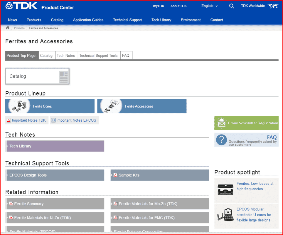

You can also look at the manufacturer's datasheet for the core you are using. The core cross-section may not be exactly square, depending on the core. The area will usually be listed in the datasheet to be used as part of the calculation of the magnetic properties of the core...
https://product.tdk.com/info/en/products/ferrite/index.html

Thanks for your reply this will be helpful to me
