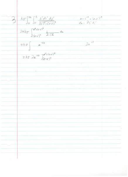

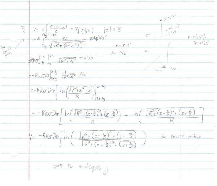

Here is where I got stuck. He told us we can use a computer, but I would still like to refresh my memory a little bit.
http://i51.tinypic.com/2ii8hlg.jpg
You need to change your limits of integration when doing the u-sub, and you are missing a negative sign [itex]du=-dz'[/itex].
Anyways,
[tex]\int \frac{du}{\sqrt{R^2+u^2}}=\ln\left(2\sqrt{R^2+u^2}+2u\right)+\text{constant}[/tex]
This is a fairly common integral that you can lookup in a table of integrals. If you want to calculate it out yourself for practise, I think you need to use the substitution [itex]v=\sqrt{R^2+u^2}[/itex] and then use partial fraction decomposition
Yeah I found that in a table in my old Calculus book, but for some reason there wasn't a factor of 2.

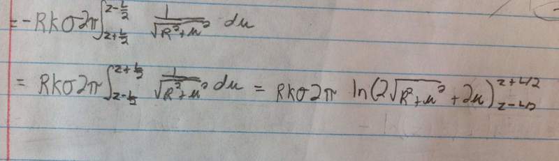

Ok so this is where I am now, I am currently working on plugging in the values.

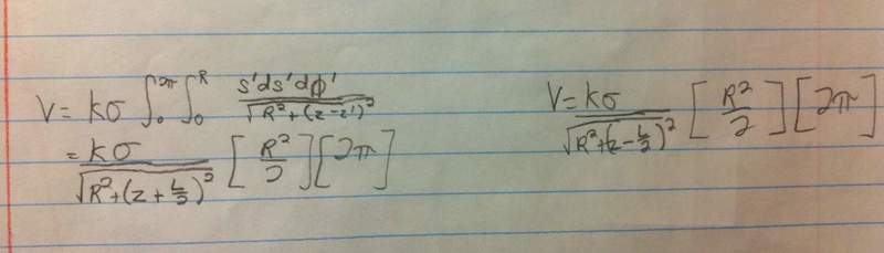

I have also attached what I hope is the correct V's for the endcaps.

I tried to do that integral by hand, and I used a substitution of u=Rtan(theta).
I ended up with an integral of sec(theta) d(theta) which integrated to ln[sec(Theta)+tan(theta)] which transformed back into ln{sqrt(R^2 + u^2)/z + u/z)

For the endcaps, [itex]s'\neq R[/itex] (except at the very edge of the endcap)... your denominator should be [tex]\sqrt{(s')^2+(z\pm\frac{L}{2})^2}[/tex]...do you see why?
Ohh yes of course. I see that now. Ok so I think I am done with the endcaps. Now for the integration of the other one, did you see my comment about the way I did it by hand? Are they somehow equivalent (using some rearranging that I am not able to figure out right now)?
