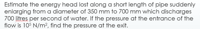

estimate the energy head lost along a short length of pipe suddenly enlarging a diameter of 350mm to 700mm which discharges 0.7(m^-3) of water per second .
the solution given is Q1= Q2 = 0.7(m^3)/s
0.7 = pi ((350x10^-3)^2 ) V1 / 4 , V1= 7.28m/s
0.7 = pi ((700x10^-3)^2 ) V2 / 4 , v2 = 1.82m/s
[(v1)^2 ] / 2g = [(v2)^2 ] / 2g +head loss
head loss = 2.53m

sorry , i missed out part of thge question . the full question given is
estimate the energy head lost along a short length of pipe suddenly enlarging a diameter of 350mm to 700mm which discharges 0.7(m^-3) of water per second .. If the pressure at entrance is 105N/ (m^2) . Find the pressure at exit

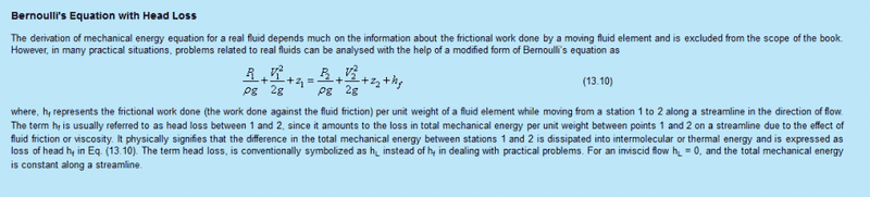

https://en.wikipedia.org/wiki/Bernoulli's_principle#Incompressible_flow_equation
head loss is also known as piezometric loss , which has formula of h = P / ρg + z ?
but , in my question , it said energy loss , shouldn't it look like this( involve (V^2) /2g ) ?

here it is , it should be 105N/(m^2)

Well, it's hard to know what they are referring to by "energy head lost." It isn't clear whether that is the same as "head lost." It also isn't clear whether the "given solution" is correct, because there is actually a head gain calculated , not a head loss.
Also, have you been learning about discharge coefficients and frictional head loss? If so, then the given solution is incorrect. There should be a frictional head loss included in the equation that is calculated from a discharge coefficient, based on the velocity at the 350 mm location (and and the diameter ratio at the sudden enlargement). So, have you been learning about discharge coefficients and, if so, what does your book give for the discharge coefficient for a sudden expansion to twice the diameter?

no , i haven't learn about discharge coefficient , but , according to the book , the loss due to expansion is given by [(V1 -V2)^2 /] 2g

For calculating the frictional head loss at a sudden expansion, see Table 7.5-1 of Transport Phenomena by Bird, Stewart, and Lightfoot.
