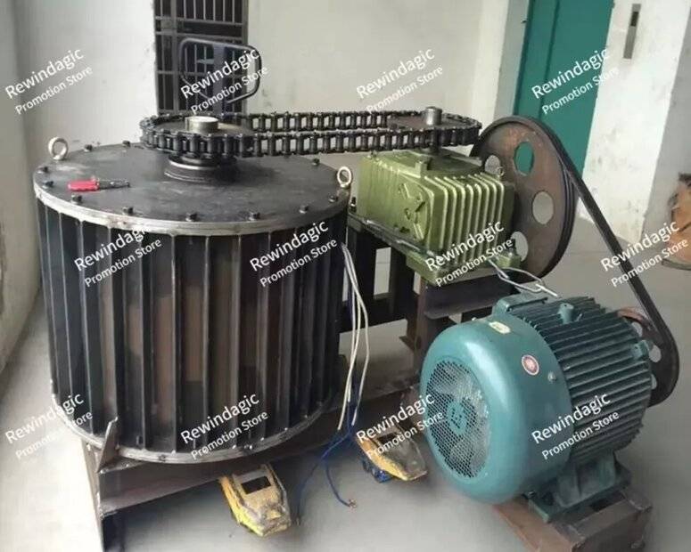

The 300 RPM will be a problem as you will probably need a gear reduction.
Can you please give us a link to the 300 RPM, 3PH alternator.
Its from AliExpress

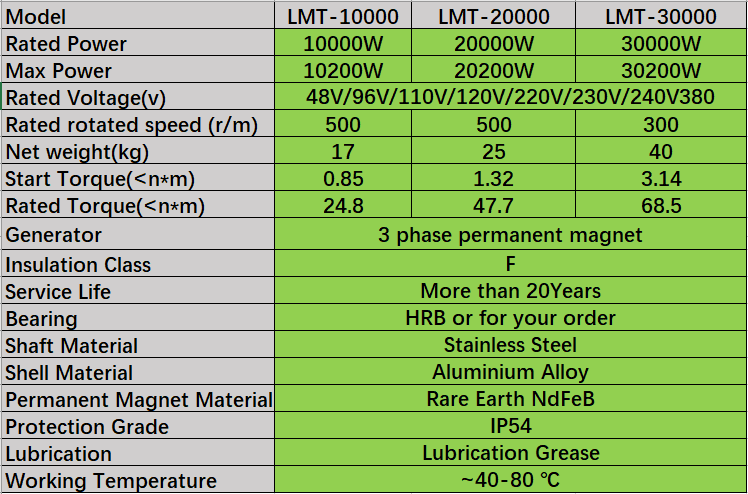

Sorry its 30kw
rizwan25 said:
Sorry its 30kw
1 HP = 745.7 watt
30 / 0.7457 = 40.25 HP
There are better 3PH alternators for faster motors.
500 RPM is for wind turbines.

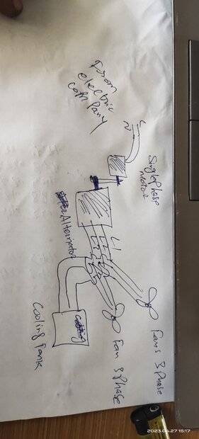

Actually i want to run with a single phase motor.
Or with solar panels that runs the motor then solar motor runs the alternator.
Is it possible to run alternator with low hp motor to get 30kw laod.
No.
Conservation of energy says you cannot get more energy out than you put in.
Power is the rate of flow of energy.
The electric energy you can take from the alternator, will be less than the energy the electric motor is consuming while it turns the alternator. The missing energy is lost as heat.
There is no such thing as a free lunch.
We do not discuss mythical free energy, or perpetual motion, on this forum.
Thank you for your guide.but in this scenario source of motor is different.mean i just take energy for 3 or 4 HP motor from an electric company that runs alternator.the production of alternator consumes the energy separately it's doesn't provide energy to single phase motor.
"Perpetual motion machine" doesn't literally just mean self powered, it is an overall category of devices that violates conservation of energy. Label the power inputs and outputs (both mechanical and electrical) on your diagram and you will see they don't match. They have to match.
