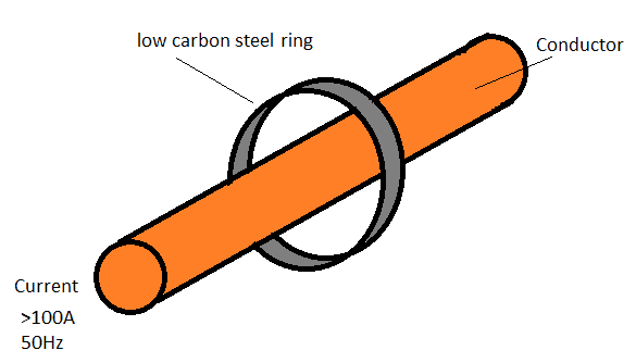

Hi
I'm looking for calculation example how to calculate iron losses in steel ring around current carrying conductor.
I have tried to find examples online, but without a suitable result.
Welcome to PF.
AC current is never passed through a steel ring, or a hole in a steel plate, without an equal and opposite current through the same ring that will cancel the magnetic field. That is required and specified in every wiring code, which is why you cannot find examples in the literature.
As a magnetic transformer core, there is no air gap in the ring to control or limit the inductance of the single conductor primary.
What is your application of such an AC conductor and magnetic topology ?

If you have only one side of the AC electric circuit passing through the ring, there will never be zero heating. What path will be taken by the return circuit?

It is the orientation of those eddy currents that is important. The magnetic field of the AC conductor follows the big circumference of the toroidal ring, a magnetic circuit. The electric eddy currents that heat the ring flow around the small circumference of the toroidal ring, through the hole.
The electric current path is short = 2⋅π⋅r , compared to the longer magnetic path length = 2⋅π⋅R , so the resistance is very low. Skin effect at 50 Hz will limit the depth of that conductive path in the surface of the iron.
Return path is outside of the ring. Theoretically yes, there will be always some losses regardless of the size of the ring, but I would assume that in practice, the heating effect on a 50 mm diameter loop and a 500 mm diameter loop would be different.

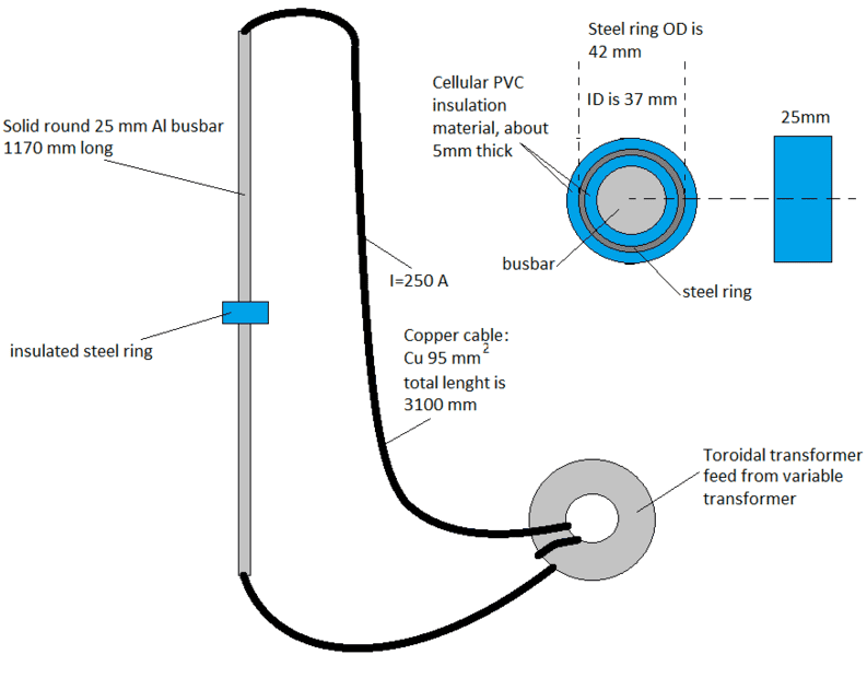

Ok, here is more information of my test setup.

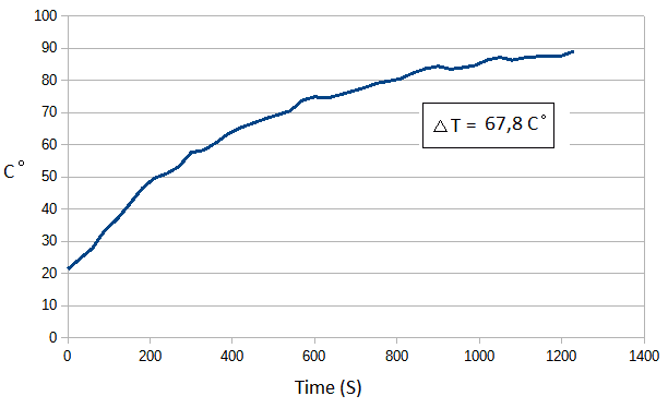

I tried to estimate the required heating power by measuring the temperature as a function of time.
The temperature change was about 67,8 degrees Celsius over about 20 minutes.
If Q = c·m·ΔT and c=0,46 kJ/(K·kg) then if I'm correct, heating power has to be at least about 1.6 W ?Are these formulas good even estimating eddy current and hysteresis losses in this kind of situation, because i'm getting about 10-20 mW total power loss or is it just that my guess of resistivity and hysteresis co-efficient factor are too off. I'm not also sure did i calculate Bmax correctly, i use Bmax =0.075 T.

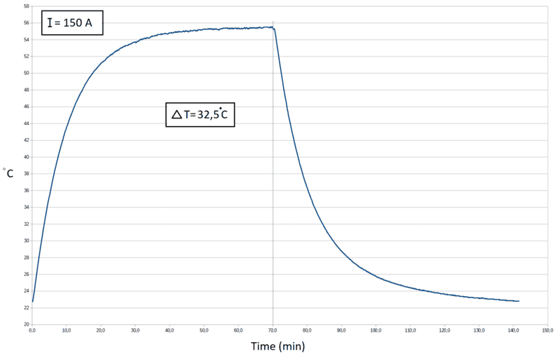

If you have the instrumentation set up, repeat the experiment up to some max T and then record the cooldown as well. From this you can easilly calculate the final steady state temperature directly I believe.
Does a log plot of that data give a good straight line?

I created this plot by manually collecting temperature readings every 30 seconds. I need to make some kind of data logger to monitor the cooling process so that I don't have to watch it myself continuously.
Yes. But are you really only interested in the steady state T rise in the ring? Then I think that is the easiest route to a good number without any physical modeling. Worth a look.

I made this plot manually by collecting temperature points in every 30 s, i need to make some datalogger to record also cooling.
I made test with a bit lower 150 A current and recorded also cooling. If we ignore conductor heating effect and look only what plot says, then if i'm right steel ring heating power is about 0.5 W. I would like to verify how the maximum magnetic flux density is calculated in this case, because I get very small values for the total iron losses compared to measured heating power?
If we don't know all the details, for an approximation, we may improvise.
I take the ring as a short pipe of 42 out/37 in 25 mm long.
The average diameter is (42+37)/2=39.2 mm. Since the busbar current is 250 A, I take field intensity H= 250/(PI()*3.95)=20.15 A/cm=2015 A/m and for a mild steel the flux density B=0.55 Wb/m^2.
If the losses for 1.5 T are 3-90 W/kg and the weight of this ring it is Vol[dm^3]*7.85[kg/dm^3]
Vol=pi()*(0.42^2-0.37^2)*0.25/4= 0.007756 dm^3. The weight= 0.007756*7.85= 0.061 kg.
Let’s take the maximum W/kg=90.
Magnetic losses [max.]=90*(0.55/1.5)^2*0.061=0.7381 W
The eddy current is proportional with B^2 and hysteresis with B^1.6.
However, the aluminum busbar evacuates some losses from the part included in the ring.
The resistance of 25mm bar- at 90oC, including skin effect -it is
2.43E-6 ohm. Then the losses are 250^2*2.43/10^6=0.15 W.
Total losses=0.15+0.7381=0.8881 W
The temperature drop through outside pvc tube of 5 mm thick is 0.6 oC and calculating Qconv+Qrad =0.881 W the ring temperature will be 60 oC [if the ambient air temperature is 40oC] or 52oC [if Ta=30oC].
