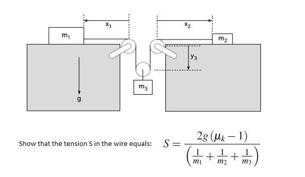

So I'm just supposed to calculate the tension in the wire (see attachment) and get to the formula shown. What I've done so far is to draw free body diagrams of all the boxes, and then I've just tried to set up some equations and manipulate them.
However, I can't seem to end up with the expression I'm supposed to end up with. I've attached my attempts at deriving a formula for S. The problem seems to be eliminating the acceleration-components. Any help would be very appreciated!

Hi gralla55. I see the attachment showing the figure. But I don't see any attachment where you show your work. The answer stated in the figure does not look correct to me.

I suggest that you take the positive directions for x1, x2, and y in the directions shown by the arrows in the diagram. This will require some changes in signs in some of your equations.
a3 ≠ a1+ a2. A good way to get the correct relation is to write the total length of the string in terms of x1, x2, and y and then note that the total length must remain constant as the masses move.

Is the correct relation a3 = (a1+a2) / 2?
I figured if one of the boxes moved, and the other stood still, the length in the y-direction would only be incremented by half because of the pulley.

Basically that's correct. But there's still the pesky signs to think about. Suppose you choose the positive directions of motion of each mass to be in the direction of the arrows in the original figure. Then if a1 and a2 are both positive, what would be the sign of a3?
Of course you can choose your positive directions anyway you want, but then you've go to make sure all of your expressions are consistent in sign with your choice. So, if you're not choosing the positive directions according to the arrows in the diagram, it would help if you would specify your choice.
All right, now I just need to figure out why I've got a factor of 2 in excess somewhere.
a3 = (2S - m3g) / m3
Does this equation look correct to you?
That's correct if you're taking upward as the positive direction for m3.
