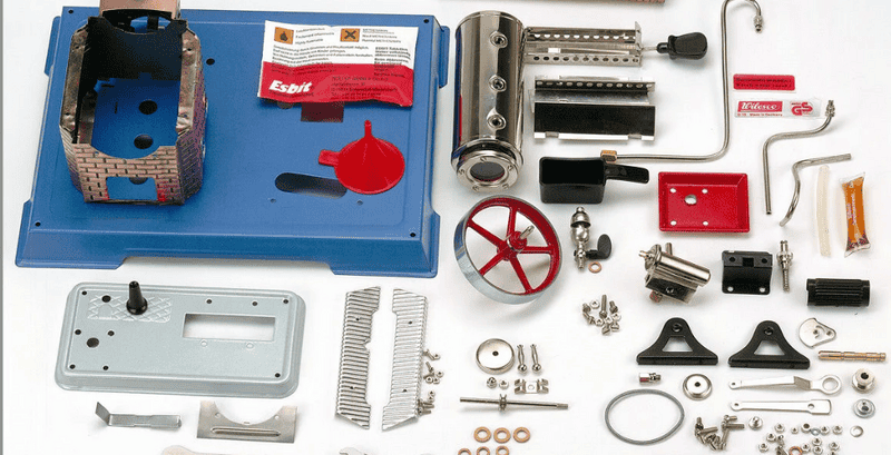

When I said I wanted something similar, I meant a small educational kit for myself. To educate myself.
https://www.ministeam.com/products/wilesco-d9
Edit Conclusion!!!!!!!: I didn't do it, I won't do it and I don't recommend anyone to do what they saw in that video.
It is not an advertisement for the kit. I don't mean exactly it! I said something like that, that is, a similar kit.
