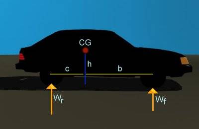

This is about vehicle physics. I know how to calculate weight on each axle on a car during deceleration. Given the picture below:
Side-view diagram of a car with a red dot marked CG at mid-height, a vertical blue line h, a horizontal line split into c and b, and orange arrows labelled Wr and Wf pointing up at the rear and front wheels.
The weight on the front axle is calculated as:
Wf=(c/L)*W-(h/L)*M*a
and the weight on the rear axle is calculated as:
Wr=(b/L)*W+(h/L)*M*a
where c and b are the distances between the center of gravity and the rear and front axle respectively, L is the wheelbase, W is the weight of the car (m*g), h is the height of the center of gravity, M is the mass and a is deceleration.

So how do I translate the equations from the first image above into the second image involving each individual wheel?
Or is there another method or simpler method of determining the weight load on each wheel instead of just on each axle?

How did you derive this? Where does the height of the center of gravity appear in your method?
I simply added another dimension. The first method has a linear dimension, forward and back, and the weight distribution is calculated by length, so I thought that adding a second dimension (sideways), made sense to calculate weight distribution as area (length*width). The second picture is a top-down view so height of the center of gravity could not be shown easily.
