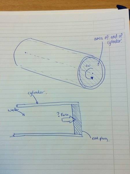

I am trying to calculate the force acting on the end cap of a rotating cylinder containing water, this is part of a university project and any help would be much appreciated.
Due to the rotation the water in the container has a pressure defined by
P=((row)*(omega)^2*r^2)/2.
As the pressure is different at each radii I believe you must us and integral in order to calculate the force F=P*A. But I am really struggling to put together the integral force F without getting a dr^2 function. Can anybody help me out with this, it would be much appreciated.

Yes I do, sorry I will try to be a little clearer.
The cylinder is rotating about an axis running through its centre connecting the centre of the circular faces on each end, (sorry not sure how to explain this better)
I am unsure about the coordinates, maybe this is where I am going wrong, I though I may be able to just integrate it using the radius as the only variable.
The equation I have put together is:
dP=(rho)*(omega)^2*r^2)/2 and dA={r^2-(r-dr)^2}*(pi)
dF={(rho)*(omega)^2*r^2)/2}*{r^2-(r-dr)^2}*(pi)
this then expands to dF={(rho)*(omega)^2*(pi/2)}*r^2*{2*r*dr+dr^2}
as rho and omega are constant in this case and when b={(rho)*(omega)^2*(pi/2)} we get the simplified formula of...
dF=b*{(2*(r^3)*dr)+(r^2*dr^2)}
is this correct and if so can it be integrated

Yes the cylinder is full. Right to tidy somethings up:
P = pressure
\rho\; = water density
\omega = rotational speed
r = radius
F = force acting on end of cylinder (due to the water pressure)
A = area of end of cylinderThe basic equations I am working from are:##P = \rho\; \omega^2r^2/2## ##A = \pi (r+dr)^2## ##F = P * ANow I think the issue I am having is that I don't understand how to use the equations to form an integral. I have calculated this in excel using a multiple slice method but would like to do this correctly.
I am fairly sure that the equation of the left does have matching units.
Also I have no done some small sketches to explain this better.

OK, now the assembly phase: You want F and realize it depends on r only since P depends on r only. So you write $$
F = \int_0^R dF(r) \ \ = \ \ \int_0^R {dF\over dr} dr \ \ = \ \ \int_0^R {dPA(r)\over dr} dr \ \ = \\ \qquad \ \ \int_0^R {d \over dr} \left ( {\rho \omega^2 r^2 \over 2} 2\pi r^2 \right ) dr
= \ \ \rho\pi \omega^2\, \int_0^R {d \over dr} \left ( r^4 \right ) dr $$
and that's not a difficult integral anymore.

OK I have used this approach:
Instead of integrating the area over the pressure which seems to be the suggestion of the OP (and why it would lead him to an awkward ##dr^2## expression), I integrated the pressure over the area:
$$\int P~dA$$
Consider the circular area of the plug in question. We will integrate the pressure over that area by adding up the pressure exerted on each concentric ring of area ##dA=2\pi r~dr##.
Each ring will have pressure ##P=\frac{\rho~\omega^2~r^2}{2}## applied to it. All that's left is to integrate from ##r=0## to ##r=R##:
\begin{align*}
F_{plug} &= \int_{r=0}^{r=R} P~dA\\
F_{plug} &= \int_{r=0}^{r=R} \frac{\rho~\omega^2~r^2}{2} 2\pi r~dr\\
F_{plug} &= \frac{\rho~\omega^2 \pi R^4}{4}
\end{align*}
edit: my answer is off by a factor of ##\frac{1}{4}## from BvU but I am not sure where he got that ##2\pi r^2## term inside his integrand.
