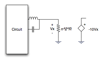

So, the circuit should look like in the attached figure, shouldn't it?
I don't understand how to modify voltages and currents. I think Vin (stage 2) will have a value of n*Vout (stage 1). Therefore, I'll have to use a controlled voltage source. However, what about current? Do I have to use a controlled current source too?
Thank you.
  • Circuit schematic: a box labeled Circuit connects through an inductor and capacitor to a resistor labeled n^2*R with voltage Vx across it, grounded below; to the right, a dependent voltage source labeled -10Vx with a plus sign on top and ground below.

Close but not quite correct. The LHS is correct but Vx still needs to be referred to the other side of the transformer before the RHS of your equivalent is correct.

Questions you should ask yourself:
1. what is the load impedance on the secondary?
2. what does that do to the voltage divider formed by your L-C network and the reflected impedance at the transformer primary?
3. what's the voltage ratio between the primary & the secondary?
The rest should be obvious.
PS - I don't recommend using controlled sources in your equivalent circuit. Better to use the fundamental properties of an ideal transformer.

You have the equivalent circuit for the left hand side correct, so analyse it as though it's a standalone circuit and determine Vx and Ix.
Now that that's done, turn to the op amp. You are using an ideal transformer, both current and voltage are transformed exactly. So the op-amp's input resistor sees a voltage of Vx/n and its current is n.Ix

So, the voltage drop in n^2*R is Vx and the gain in the ap-omp stage is Vo = -10*Vx/n.
Is it correct?
I think another solution would have been to multiply L and C by 1/n^2 and the input voltage by 1/n, right?

Yes...though I'd phrase it as the voltage across ...
Try it and see whether you get the same answer.
Bromio said:
I've got the same answer!
Then something's wrong.
I'm going to give you the answer, since you've worked at it quite a bit:
Vo/Vi = -10(sC + 1/sL)/n(sC + 1/sL + 1/n^2*R)
= -10[(s^2)LC + 1]/n[(s^2)LC + sL/(n^2*R) + 1]
Tip: when dealing with parallel components like your L-C network it's easier to deal with admittances and conductances than with impedances and resistances. That's how my first equation above came about.
BTW the sign is determined by whether the dotted ends of the xfmr are adjacent or not. The minus sign assumes they are. The schematic should have shown this.
NascentO2, did you get the same thing?
