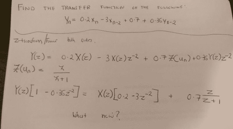

Hi,
I'm asked to find the transfer function for the following digital filter described by a difference equation
Handwritten working finding the transfer function of a difference equation: Y(z) = 0.2X(z) - 3X(z)z^-2 + 0.7Z(u_n) + 0.35Y(z)z^-2, with Z(u_n) = z/(z+1) and the line Y(z)[1 - 0.35z^-2] = X(z)[0.2 - 3z^-2] + 0.7z/(z+1), ending with the question 'What now?'
[/B]
Usually if there's no constant term (0.7) here, I can just rearrange in the form of Y(z)/X(z) to give me H(z). But I can't do that here. So what now?
You can do that.
The definition of a transfer function is output per input.
This is like an R-C divider with an initial charge on the C. The transfer function is the same irrespective of that charge.
