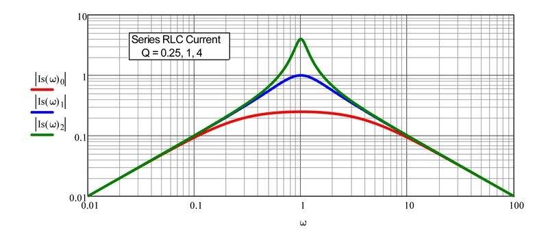

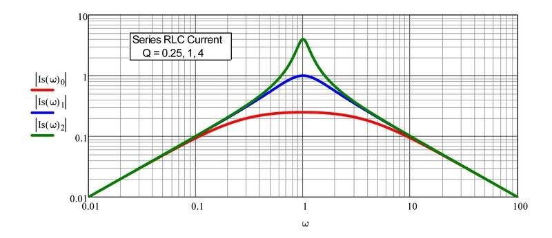

As you said, you can't plot the response versus frequency without knowing the RC value. That's OK, it's built into the problem. You can just make a bode plot that has log(Ω) on the x-axis instead of log(f) [frequency]. We call this normalization, which can be useful to describe a whole class of problems. They've already defined a value that every frequency is referenced to, Ω=ωRC, so your frequency is f= Ω/(2πRC). Then put a label on your graph that states that definition. This would allow another engineer, who does know the value of his particular RC, to easily relabel the graph in Hertz for his case.
Here is an example for a different circuit (your Ω is the same as my ω).
Log-log plot titled Series RLC Current with Q = 0.25, 1, 4, showing |Is(ω)| against ω from 0.01 to 100. Three curves peak at ω = 1: red (Q = 0.25) peaks near 0.25, blue (Q = 1) near 1, green (Q = 4) near 4.
Interpolation is a straightforward method of estimating values between your data points. Unless someone says otherwise you can assume they mean matching a linear function to two data points and using that to find intermediate values. This should be easy to learn about with a web search. Research it and ask if there's something you find confusing in the explanation.

Great answer! So now if I want the values of the diagramm (magnitude and phase) i can just plug in the given values in the formulas and when drawing the diagramm add the label that its normalized on the x axis?
