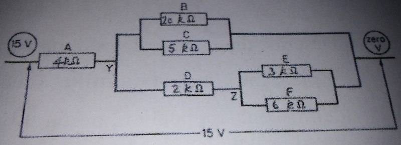

For the circuit shown below, determine
i) The voltage (V) at points Y and Z.
ii) The current through each resistor.
V=IR, I=V/R, R=V/I
For (i) do I have to split into series and parallel?
The circuit is already split into series and parallel. To make some calculations in (i) easier, you'll want to [temporarily] combine some of the parallel paths into a single resistance.
