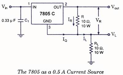

i need to use as a portable charger(POWER BANK) for my mobile
can i use LM7805 to deliver my rated output !
please guide me with circuits !

A 6V NiMH battery is a 5 cell battery pack. At peak charge it can be close to 7.5V.
Most cell phones have a 5V charger, and you need to be able to supply the current supplied by the charger.
You need to calculate the maximum power dissipation in the regulator and use a proper heatsink.
http://www.jameco.com/Jameco/Product...DS/1731278.pdf is the wrong voltage, but has a nice section (page 10 and 11) on thermal considerations.
Looking at a 7805 spec, if your phone draws 500ma, then the regulator will dissipate 1.25 watts. (2.5V X 0.5A). A TO-220 package with no heatsink would heat to 65 x 1.25 = 81.25 degrees C above ambient. (which means you should probably use a small heatsink)

Will this help me to produce constant current from LM7805 !
also tell me what is input should be provided for this circuit !
Why do you want a constant current?

Sorry, When I say "supply the current" I don't mean you need to build a current source.
When I said "supply the current", I meant you need to create a 5V Voltage source that is capable of supplying the required current without overheating. Carefully analyze my 7805 example and read the Thermal section on the other data sheet I linked to.
No you don't want constant current, you just need a somewhat stable voltage around 5 volts. That is, you need to go from the somewhat stable voltage of around 6 to 7 volts that your pack provides to a somewhat stable voltage around 5 volts that the phone's internal charging circuit requires.
A simple linear regulator will probably give the best results, but if you want something really quick and nasty then two series silicon diodes would probably get the job done (eg 1 or 2 amp general purpose diodes).
If you do go for a linear regulator then don't use the 7805, there may not be enough input to output voltage differential for it to work properly. Get a low dropout type like the LM2940 for example.
Regardless of what regulator you use (chemnoob is right, 7805 is marginal to bad, LDO is better) make sure you understand the power dissapation as I described.
