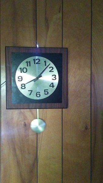

I know one can use a LM317 to cut 12 volts dc to 1.5 volts but can one use resistors? I have a wall clock that runs a small motor to wind spring and it powered by a c battery you can run on more voltage without out damage to any thing as it only run for 1 second every 2 minutes. I tried a 30 ohm resistor but it still must be to much voltage as when it winds up the spring it it goes to far causing it not to release the switch when unwound. Do these small brush type dc motors draw a constant load from startup thru full speed running? can't imagine these motors draw many amps running off a c battery. I was also wondering when you use a resistor to cut voltage down do you also lose amps?

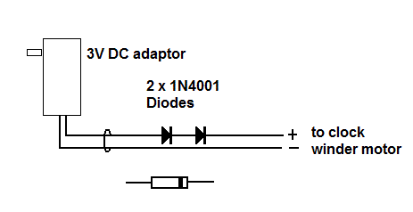

as @jim hardy said, no
do as he suggested and use a 3V wall adaptor and you could put a couple of 1N4001 diodes in series with the positive wire and that will drop ~ 1.4V and you will be close to spot on for your 1.5V requirement

I seemed to got it to work just went up to 60 ohm resistor used 10 watt only thing I am not sure of is should one put oil on these wire brush as this would make them wear less but probably get dirty faster is this not right? I am running this off house solar power that is why I wanted to do this as have lots of free solar power.

When they said resistor is not going to work that sure was right I had to go back to the way it was using carbon c battery only thing I added that seems to work is a put a 10 watt 600 ohm resistor in between 12 volt dc and battery it only raises battery voltage .01 of a volt I think this should be perfect as battery voltage with 12 volts applied thru resistor was at 1.61 volts. I tried 1000 volt resistor didn't seem to raise battery voltage and 300 ohm raises battery voltage .02 of a volt. Once in a while it stops I am always thinking it is the motor brushes not making contact but this does have a magnetic reed switch I might have to put a LED on motor terminals so when stops running motor so I can tell if power is getting thru switch to motor cause just because you hear switch snap does not mean switch has closed. Is a magnetic reed switch a lifetime type of switch or can contacts go bad?

Seems to work this way
