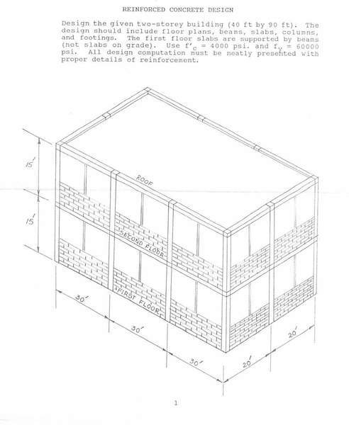

hello everyone
i have to design a simple two floor office building with roof.
i am very lost and confused and don't know where to start from.
can someone help?pleaseeee
Isometric line drawing of a two-storey building 40 ft by 90 ft with a flat roof, labelled first floor and second floor, with 15 ft storey heights and bay dimensions of 30 ft, 30 ft, 30 ft, 20 ft and 20 ft, and the header text Reinforced Concrete Design.

This looks like a static load and strengths of materials problem. You need to specify the type of beam foundation, floor slabs, exterior and internal columns, and roof to be self supporting for static loads only.
Define your roof and floors, calculate weights, If needed, define support beams to support roof and floors, then design columns to support those loads, then define foundation beams to support the full structure.
Hope that helps or somebody with more civil structural background can chime in. It also might help if you would tell us what level of education, statics, materials and math background you are working with.

Start at the roof and work downwards. You can't design the top floor till you know the weight of the roof it has to support.

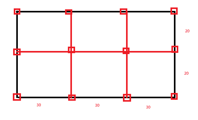

That is more clear than what I wrote. Based on the nodaliztion in the drawing woud you agree that the design probably includes two internal columns on each floor?

yes i agree but how would i find the weight of full roof?
no load is given i can find the dead load
DL=150 lb/ft^3 x cross section
but i can't because its roof...should i just assume snow load?

u mean like this?
Line drawing of a rectangular grid of black beams and red-highlighted columns, with dimensions labelled 30 along the bottom and 20 along the right side.

No information in the problem definition about snow load so assume none.
Yes
