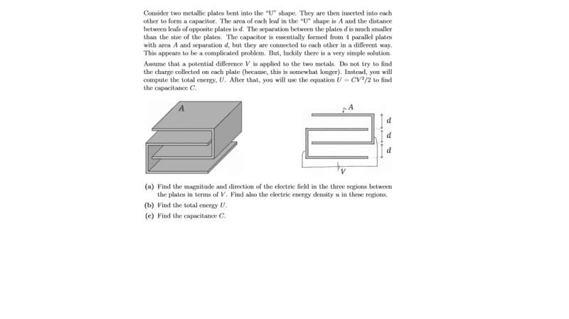

In attachments

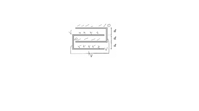

Two diagrams of a capacitor made from U-shaped metal plates: a 3D view with plate area A labeled, and a side view with separations d labeled three times and a voltage V across the connecting leads.
Hand-drawn diagram of three parallel plates stacked vertically, separated by gaps labelled d, with a battery labelled V connected across the outer plates and a point charge Q near the middle plate; field arrows shown as crosses and dashes.
This is my charge distrubition.From there I draw electric field lines.And then from potential difference I wrote
##E=\frac {V} {d}## and then ##υ=\frac 1 2ε_0E^2## then ##U=\frac {CV^2}{2}##
I am doing something wrong..I guess I should decide to Are these plates connected in parallel or in series ? But I don't know how to decide that

So far, I don't see anything wrong. What did you do from this point?
Using the approach of this problem, you do not need to decide whether the plates are in parallel or in series. Your answer will tell you if the plates are in series or parallel.
Which part are you working on?
You have a relation between U and C, but you have to determine both.

Welli I found (a) and it is ##E=\frac {V} {d}## then Energy density will be ##υ=\frac 1 2ε_0E^2## .
I am stucked here I wrote for (b) ##U=\frac {CV^2}{2}## but I don't know what's the "U".Its like saying ##U=U## (I found like this) Thats why something seemes wrong.

How would you express the total U of the system in terms of electric field energy?

Not like that I meant ##U_{tot}=3U=3(Ad)υ=3(Ad)\frac 1 2 ε_0E^2=\frac {3CV^2} {2}##
Arman777 said:
##U_{tot}=3U=3(Ad)υ=3(Ad)\frac 1 2 ε_0E^2##
That part is fine.
##=\frac{3CV^2}{2}##
That would need a "capacitance per layer" or something like that. Don't do that.
You have the total energy, you know the voltage, that is sufficient to determine the total capacitance.

##C_{tot}=3ε_0 \frac A d## ?
Yes. But I can't tell how you got that.

##3(Ad)\frac 1 2 ε_0E^2=\frac {CV^2} {2}## and ##E=\frac V d##

Can you tell from your answer if the three gaps in the system act like capacitors in series or do they act like capacitors in parallel?
parallel
