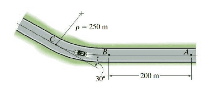

When the car reaches point A it has a speed of ##25m/s##. If the brakes are applied, its speed is reduced by ##a_t = -\frac 14 \sqrt{t} \frac {m}{s^2}##. Determine the magnitude of acceleration of the car just before it reaches point ##C##.
##s = R*\theta##
So I get the exercise and all and have just solved it. But .. I kind of very very intuitively determined ##\theta## to also be the angle for the circular sector.
The problem here is that my geometry bag is very weak, I didn't have any geometry in HS, will fix that sooner or later but anyway. so... My question is.. how do I 'actually' derive that the angle of the circular sector equals ##\theta = 30## degrees in such situations?
Thanks in advance.
My thought process was, okay so theta keeps increasing as we move along the circular segment which probably implies that the angle of the sector ##= \theta##
note: the circular path is from B --> C. It might not look as it is due to the placement of the center of curvature, but it is.
Good. We can't: the image is severly blurred and illegible.

simphys said:
that the angle of the sector =θ
That's correct. The heading of the car changes bij 30 degrees.
yes but I don't get why that implies that the angle of THE CIRCULAR SEGMENT also equals ##30## degrees.
The tangent to the circle is always at right angles to the radius. Increase one and the other will increase by the same amount/. Is that your problem?
Oh, so basically.. the angle b/n two tangents is equivalent to the angle between normals of the tangents? Is that what you meant? And then from this we know that it's going to be the angle of the circular segment.
Yes. It's simple geometry. The two lines are fixed with 90° between them. Increase one by x and the other will increase by x. Imagine a set square rotating around a pivot on one arm. Every part of it will be rotating by the same angle

There is a theorem in geometry: angles with perpendicular sides are equal. This means that if the sides of one angle are each perpendicular to one of the sides of the other angle, the two angles are equal. It is quite useful in physics problems.

so from that theorem we get ##\phi## == ##\theta##, correct?
Look at the left hand side of the image linked below. This is what I was talking about.
https://etc.usf.edu/clipart/48200/48228/48228_angperpsides.htm
The angles 7 and and 1 in the fiure on the left hand side are like this and they are equal. Each side of the angle 7 is perpendicular to one od the two sides of the angle 1. The sides are perpendicluar and not the angles.
