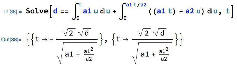

So I've gone to my friend for help, who's told me about using integration. I'll just paste screenshots of what was given to me for this:
243222
as a representation of the problem to then plug into Wolfram Mathematica to solve for t:
243223
So of course we're never going to have negative time, so the positive answer has been used in my equations, however this is very much a black-box solution for me and therefore not really something I can work with and check it's correct, which is definitely an issue right now because I'm getting odd answers for T when putting in values of acceleration and deceleration. For instance, when I put in a higher value for deceleration, t goes up. Also I think if I swap acceleration and deceleration, t should remain the same, but they currently don't?
Can someone either verify for me that what's been given to me is definitely correct, or propose a different way for me to solve this, or just generally help/sanity check this for me?

The answer doesn't look quite right to me. For example, if you make ##a_1 = a_2## then your answer is:
##t = \sqrt{\frac{d}{a}}##
Can you solve the problem for the case where the acceleration and deceleration have the same magnitude and confirm this is wrong?
It does indeed seem wrong. So this is what I've done to prove this wrong:
Using ##D = \frac{at^2}{ 2}## and:
## a_1 = a_2 ##, so therefore:​
##t_1 = t_2 ## and ##d_1 = d_2##​
##T = 2 * t_1##, and therefore ##t_1 = \frac{T}{2}##​
##D = 2 * d_1##​
##D = at_1^2##​
##= a (\frac{T}{2}^2)##​
##= \frac{aT^2}{4}##​
Rearrange for ##T##:​
##T = \sqrt{\frac{4D}{a}} \neq \sqrt{\frac{D}{a}}##​
Is this right?

Yes, that's the correct answer when ##a_1 = a_2##.
Note that the distance traveled is the area under a velocity vs time graph. If you draw a graph and use some geometry, you may find an easier way to get this answer; and, this may help for the case where ##a_1 \ne a_2##.
PS here's another interesting thing that you may be able to see from a graph. Don't worry if you don't understand this yet. From the graph I could see that the answer should be symmetric in ##a_1, a_2##. That means that if you swapped ##a_1## and ##a_2## round, you should get the same time.
E.g. if the acceleration was ##a_1 = 5m/s^2## and the deceleration was ##a_2 = 2m/s^2##, then that should take the same time as the other way round with ##a_1 = 2m/s^2## and ##a_2 = 5m/s^2##.
Now, the original answer your friend got was not symmetric is ##a_1, a_2##. If you swap them over you get a different answer. So, you can see that that answer must be wrong.

So after more asking around, someone's presented to me the idea that maximum velocity would be the same for acceleration and deceleration which is pretty obvious, but I didn't think to include this in the equation. Is this what you're getting at?
So therefore using ##v = at##:
##a_1 t_1 = a_2 t_2##, so therefore ##t_2 = \frac{a_1 t_1}{a_2}## (eqn. 1)
Substituting (eqn. 1) into ##T = t_1 + t_2## and rearranging would give us:​
##T = t_1(1 + \frac{a_1}{a_2})## (eqn. 2)
Leaving us needing to find ##D = \frac{1}{2} ( a_1 t_1^2 + a_2 t_2 )## (eqn. 3) in terms of ##t_1(1 + \frac{a_1}{a_2})## to find ##T##:
Substituting (eqn. 1) into (eqn. 3):​
##D = \frac{1}{2} ( a_1 t_1^2 + a_2 \frac{a_1 t_1}{a_2})##​
Doing a bunch of rearranging:​
##D = \frac{a_1 t_1}{2} \cdot t_1 (1 + \frac{a_1}{a_2})##​
Substituting (eqn. 2) and rearranging for ##T##:​
##T = \frac{2D}{a_1 t_1}## (eqn. 4)
So to get rid of the final unknown ##t_1##, from (eqn. 2) we have:
##t_1 = \frac{T}{1+\frac{a_1}{a_2}}## (eqn. 5)
Substitute (eqn. 5) into (eqn. 4) and rearrange:
##T = \sqrt{\frac{2D (a_1 + a_2)}{a_1 a_2}}##​
So it looks like I have an equation for total time! I hope it's right. Will test it with a few variables.
Here's how I did it, using the idea that ##D## is the area under the velocity time graph, which is made up of two triangles. The height of the triangles is ##a_1t_1 = a_2t_2##; and its length is ##T##. Therefore:
##D = \frac12 T a_1t_1##
Now, using your equation (2), we have ##t_1 = \frac{a_2}{a_1 + a_2}T##, hence:
##D = \frac12 T^2 \frac{a_1 a_2}{a_1 + a_2}##
And, the result follows.
