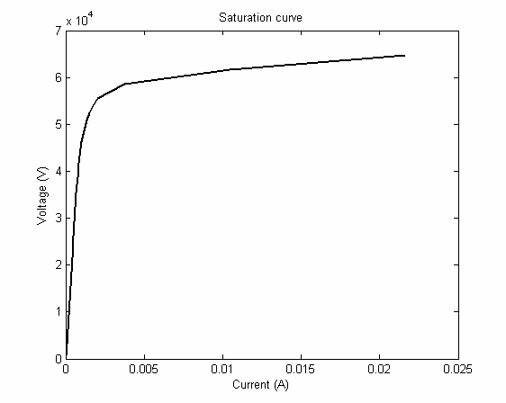

The simplest thing, if you have twice the stimulus, you get twice the response.
For example, V=IR. Double V, holding R constant, and you double I.
An example of nonlinear.
Line graph titled Saturation curve, plotting Voltage (V) on the vertical axis with a scale factor of x 10^4 against Current (A) on the horizontal axis from 0 to 0.025. The curve rises steeply at low current, then bends and flattens out gradually at higher current.
Edit: An important property of linear circuits is that you can superimpose solutions.
With V=IR, suppose we solve for a step function in V, then solve for V=sin(wt). Add both kinds of V together, and you just add the separate solutions for I together. That's a huge advantage in analysis.
