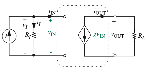

In the shown depictions of a dependent source there is an input side and an output side. How exactly are they connected?
The amount of voltage provided by an independent voltage source and the amount of current provided by an independent current source do not depend on the circuit they are in.
There are other types of sources, however, that do depend on the circuit they are in. That is, such dependent sources depend on (ie, are controlled by) other parameters in the circuit.
Here are depictions of four types of dependent sources
Figure 2.66: four circuit symbols for dependent sources, each with an input port on the left and an output port on the right: (a) VCCS, (b) CCCS, (c) VCVS, (d) CCVS, with g, alpha, mu and r as gains.
To summarize my question: how is the left side connected to the right side in practice?

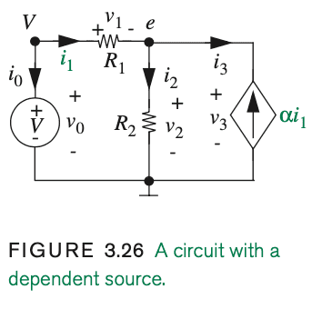

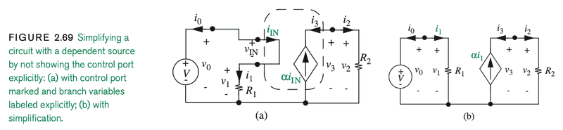

For example, consider the following circuit containing a current controlled current source (case b above)
Two circuit schematics: (a) with control port marked and branch variables labeled, showing V source, R1, R2, dependent current source alpha i1N and currents i0 through i3 with voltages v0 through v3; (b) simplified version with alpha i1 dependent source.
How exactly is it that the depicted input port affects the dependent current source?
I see that there is a connection in the center bottom. Is the connection between the input side and output side as simple as this or is the depiction somehow simplified?
It seems there must be some other connection. As far as I can tell, basic circuit analysis would predict no current in the bottom connection part.
  • Circuit schematic of a voltage-controlled current source: left, current source I feeds node with resistor RI, labelled vI, iI and iIN, vIN; dashed box; right, dependent source g vIN drives iOUT into load RL with voltage vOUT.
These are idealized circuit models. There is no "why, or how", it is defined to be that way; by magic, I suppose. You can not build this circuit element in the real world, but they can be useful things to build simple models of real world processes... sometimes.
The question cannot be answered in general, because the "connection" between input and output is physically different for each active element working as a "dependent source".
But if you know the working principle of the electron tube or the transistors (FET or BJT), then the answer is automatically given.
The basic input-output relationship of the two-port network is defined by the equation. Whether there is a bottom connection depends on your application and decision. If connected together the potential is the same, if not connected the potential difference is undefined
For example, there is no connection between the input and output of an isolation transformer through which actual current can pass.

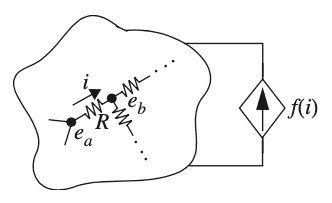

Consider the following reasoning that appears in the book I am reading.
We have the following general depiction of a circuit containing a dependent current source
Schematic of a network of resistors in a blob-shaped region, with branch current i marked, connected to a diamond-shaped current source labelled f(i).
Now suppose that the circuit on the left has the node voltages as shown below
Schematic of a generic circuit block with two terminals e_a and e_b joined by a resistor R carrying current i, with its output driving a diamond-shaped controlled source labelled f(i).
Then we can express the element law for the dependent source as a function of the node voltages:
$$I=f(i)=f\left (\frac{e_a-e_b}{R}\right )$$

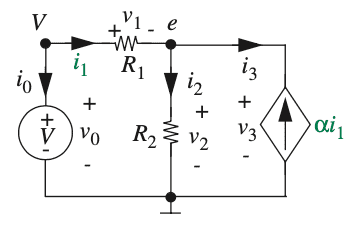

And then the book gives a concrete example:
Circuit schematic with a dependent source: voltage source V on the left feeds a resistor R1 to node e, then a resistor R2 down to ground, and a current-controlled source alpha times i1 on the right, with labelled currents i0, i1, i2, i3 and voltages v0, v1, v2, v3.
This circuit has one dependent source, namely a CCCS (current controlled current source).

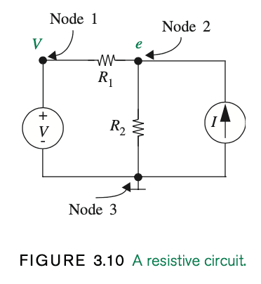

To analyze this circuit using the node method, we first replace its CCCS with an independent current source carrying a known current, say ##I##, and analyze the resulting circuit.
The circuit becomes
Resistive circuit with three nodes: Node 1 at voltage V, Node 2 at voltage e, Node 3 at the bottom. A voltage source V is between Node 1 and Node 3, resistor R1 connects Node 1 and Node 2, resistor R2 connects Node 2 and Node 3, and a current source I is between Node 2 and Node 3.
We can easily solve the above circuit with the node method, and the solution for ##i_1## is
$$i_1=-\frac{R_2}{R_1+R_2}I+\frac{1}{R_1+R_2}V$$
Of particular interest is the value of ##i_1## because ##i_1## controls the CCCS. Using the result for ##i_1## we next write
$$I=\alpha i_1=\left ( -\frac{R_2}{R_1+R_2}I+\frac{1}{R_1+R_2}V \right )\tag{3.49}$$
and we solve for ##I##
$$I=\frac{\alpha}{R_1+(1+\alpha)R_2}V\tag{3.50}$$
The actual value of the CCCS is now known
Finally we back-substitute Equation 3.50, namely the actual value of ##I##, into the equations that formed the solution of the circuit in Figure 3.10, thus completing the analysis of the circuit in Figure 3.26.
We get all the solutions in terms of just ##V## and no longer ##I##.
For example,
$$i_1=\frac{1}{R_1+(1+\alpha)R_2}V$$

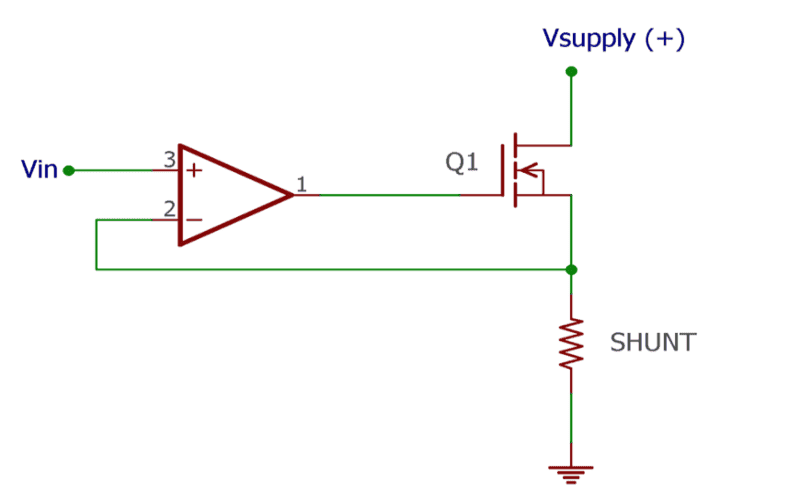

berkeman said:

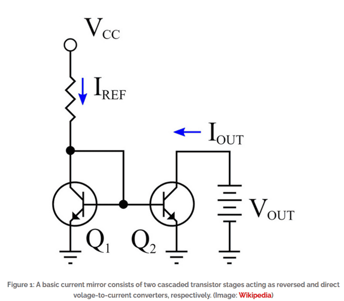

Perhaps look into how Current Mirrors work
Should this be a current-controlled current source, a current-controlled voltage, a voltage-controlled current source or a voltage-controlled voltage source?
If it is CCCS, it corresponds IOUT /I REF
If it is CCVS, it corresponds VOUT / IREF
If it is VCCS it corresponds IOUT /V CC
If it is VCVS, it corresponds VOUT / V CC
It seems that this circuit contains four possibilities :smile:
Vcc sets Iref, so in a sense it is a VCCS.
I totally agree it's a VCCS.
1. The circuit diagram has marked the input as a voltage source.
2. The output of the circuit is a current source that changes with the input voltage, so the output current will not be affected by the battery voltage.
3. It is impossible to claim that this is a VCVS because the constant voltage of the battery is not affected by the input voltage or output current.
Sorry, I haven't looked at this circuit diagram in detail before.

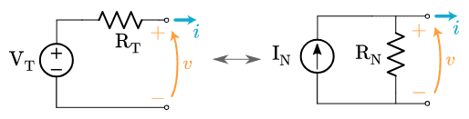

A comment about sources in linear networks:
We know that the Thevenin-Norton source transformation theorems say that any voltage source branch can be expressed as a current source, and vice-versa. Like this:
Circuit diagram of a Thevenin equivalent: voltage source V_T in series with resistor R_T, with terminal voltage v and current i, linked by a double-headed arrow to a Norton equivalent: current source I_N in parallel with resistor R_N.
Where In = Vt/Rt or Vt = In⋅Rn and Rt = Rn.
So, in practice, what really is the difference between a current source and a voltage source? It's simply the value of ##Rt=Rn## compared to the other impedances in the circuit. Current sources are very high impedance so that ## \frac{\partial i}{\partial v} \approx 0##; the output current doesn't change much if the output voltage changes. Voltage sources are very low impedance so that ## \frac{\partial v}{\partial i} \approx 0##; the output voltage doesn't change much if the output current changes. Note that these derivatives are the definition of the source impedance ## \frac{\partial v}{\partial i} =Rt=Rn##.
IRL, sources live on a continuum with most somewhere in between.
Also note that a perfect voltage source with ##Rt=0## can't be transformed into it's Norton equivalent and vice-versa. However, as soon as you connect it to a network, it can be converted using the driving point impedance of the network.
zenterix said:
Finally we back-substitute Equation 3.50, namely the actual value of I, into the equations that formed the solution of the circuit in Figure 3.10, thus completing the analysis of the circuit in Figure 3.26.
We get all the solutions in terms of just V and no longer I.
You define CCCS in the circuit and get equation ##~~ i_1=\frac{1}{R_1+(1+\alpha)R_2}V ##.
So do you feel like you now have a good understanding of the dependent sources in general circuits?:smile:
