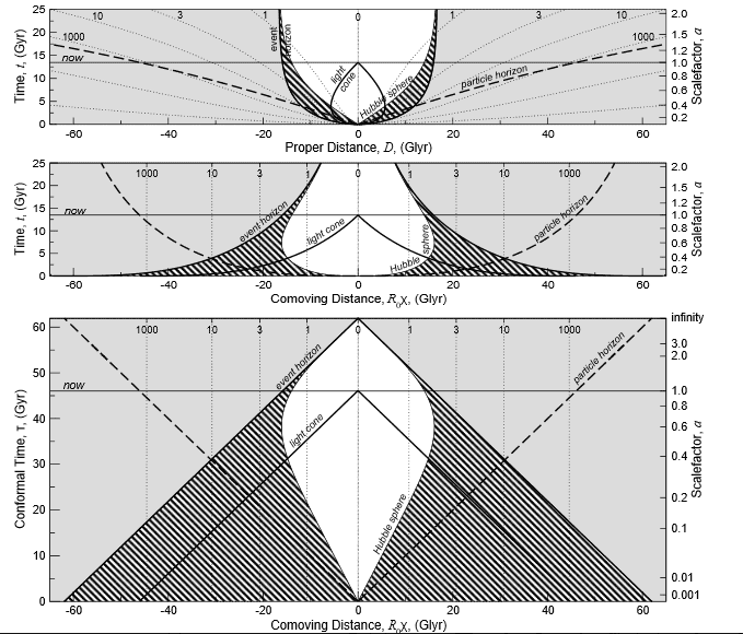

Yes. The numerical value of the comoving distance is by convention chosen to equal the present (proper) distance. It could have been the distance at any other time, in principle, but the current distance is simply a convenient choice. For all intents and purposes, ##x_0## is the comoving distance.
Comoving distance is a convenient measure in an expanding universe, since it exactly factors out the expansion, and tells you just about the relative positions of points in space.
For example, take a look at the two top graphs shown below, relating time and distance in our universe:
(graphs taken from: https://arxiv.org/abs/astro-ph/0310808)
Here, the dotted lines marked with redshifts (1, 3, 10, 1000...) can be visualised as some test galaxies. On the first graph, which uses only proper distances and proper time, the spatial relationship between those galaxies is hard to discern, especially towards the bottom. But if you factor out the expansion by adopting comoving distances, it becomes much more clearer.
Notice how at the horizontal line marked 'now' both the proper distance and the comoving distance to the same galaxies are equal.
The third graph does the same 'trick' with time, i.e. it scales the time with the scale factor, but it's less relevant here.
@Bandersnatch
Why is it that comoving distances, which factor out expansion, "scale with expansion"?
On those graphs, what is are the comoving and proper distances referring to? Distances of what exactly? Everything in the universe?
Regarding the Insights article, is the distance traveled by light/sound between two points in the universe not affected by the expansion of the universe, during the time that it is travelling?
The graphs are meant to show relationships between various types of cosmological horizons. Such as the event horizon or the distance at which recession velocity reaches the speed of light. You can also see distances to the regions of space containing objects which emitted currently measured redshifts (dotted lines). In comoving coordinates those regions, just as any other given region in space, always have the same coordinates (same comoving distance from the observer).
Anyway, probably better not to focus on those too much, as they seem to be a distraction.
