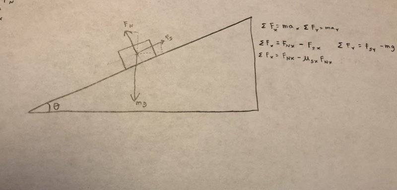

Here is my attempt at this so far. I can barely even start this because doing this without rotating the axis just doesn’t make sense to me. Should I put my x-axis through the center of the object parallel to the ground rather than on the ground?
  • Handwritten free-body diagram of a block on an inclined plane at angle θ, with normal force F_N, static friction f_s, and weight mg labelled, plus force-balance equations beside it.

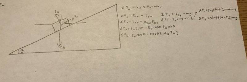

Now I have a little bit more, but have no clue where to go now.
  • Handwritten free-body diagram of a block on an inclined plane at angle θ, with forces F_N, f_s and mg labelled, beside handwritten force-component equations including ΣFx and ΣFy.
You have written that ##F_{sx}=\mu_{sx}F_{Nx}##.
First, ##\mu_{sx}## doesn't mean anything. μs is just a number. It cannot have x and y components.
Second, the frictional force depends on the normal force, not on just some component of the normal force.
You know that the frictional force has magnitude μsN. You know the direction of that force. What is its x component?
Third, you have written that the x component if the normal force is FNcosθ. Check that. Does it make sense when θ=0?
(μs)cosθ for the x-component?
Oh crap, would it instead be Fnsinθ?
edit: Sorry, not sure how to do subscripts on here
So I managed to figure it out surprisingly. Thank you all for the help.
