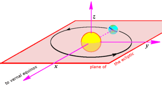

How to find Planet Heliocentric latitude data ?
Does anyone know where to find information (or software or calculator) able to show on which days / time (2021) where Mercury (and other planets) are as low/high as possible on the heliocentric latitude
For example: like the animation seen in the link below.
The problem with this site is that the animation runs too fast, - so it is not possible to stop it at the time you want.

You might find NASA's JPL's Horizons System useful.
https://ssd.jpl.nasa.gov/horizons/app.html#/
  • Pick you favorite planet for the "Target Body."
  • Pick whatever location you like for the "Observer Location" (I don't think it matters for this particular case, if I'm interpreting the system correctly [I've never actually used it for this myself]).
  • Edit the "Table Settings" where you will find a checkbox labeled,"Heliocentric ecliptic lon. & lat." and check it.
When it generates the table for your specified "Time Specification" settings, a couple of the columns will be the Heliocentric longitude and latitude.
Heliocentric latitude is what I assume you're interested in here.
https://en.wikipedia.org/wiki/Ecliptic_coordinate_system
It won't spit out the minimum and maximum for you automatically, but you should be able to find them by playing around with it.

I have one more question, and that is: - how much the planets' lowest (or highest) position in the sky "rotates" (relative to the Sun's Equator) - through time.
Example: - let's say that the Earth's lowest position relative to the Sun's equator is March 1st this year.
I imagine that there is a rotation of this lowest (and highest) possible position and therefore that this date (March 1st ) changes every year.
How long a period does it takes for a complete one "rotation" (360°) of such "lowest position".
Same question for the other planets in the solar system. - Where can this information be found?
What is such a "rotation" called?
The Earh's orbit is basically fixed in space, but it does rotate slowly. This is called the precession of the perihelion. This is not to be confused with the precession of the Earth's axis, which takes about 26,000 years to complete a cycle. The precession of the perihelion, which is what you are asking about, for the Earth is about 5 arcseconds/century, which means it takes about 25 million years to complete a full rotation.
Precession of perihelion I understand.
The question is: what about planets lowest (or highest) position in the sky (relative to the Sun's Equator) - ( planet latitude) Does these planets lowest (or highest) position rotate too , - or are these always pointing to the same direction.
There is the precession of nodes, too.
