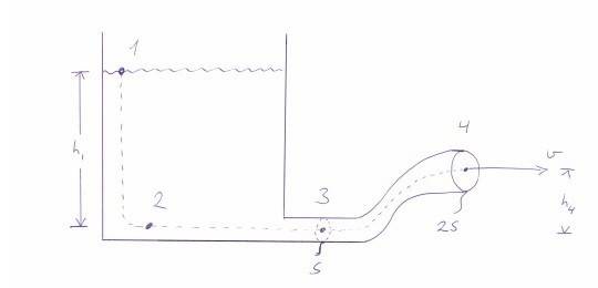

Pandaphys
A tank is filled to the depth h1 with a liquid with mass density p Over the liquid surface is an atmospheric pressure po. From the bottom of the tank there`s a tube with cross-sectional area of ​​S. Tube expands to double cross-sectional area 2S while bending up to the height h4. Out of the pipe the fluid flows with velocity v.
Find the pressure in 1, 2, 3 and 4
Please help on getting started?

Use Bernoulli's equation and continuity equation.
