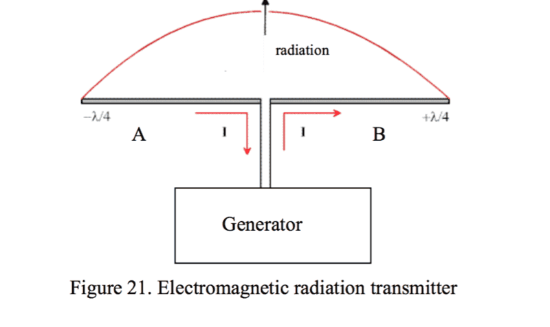

For a 150 MHz (1 MHz=1 million cycles per second) radio signal, the wavelength is 2 m long. If each wire is about 0.5 m long, a half wavelength of radiation will span the two wires taken as one. The result is that electromagnetic waves are generated in the direction of the arrow, moving away from the transmitter at the speed of light.
To transmit radiation of wavelength 1, how long should each wire be in multiples of (or fraction of) 1?
I'm not sure if this is the answer, but I was thinking the length of the wire could be 0.25m if the wavelength is 1? I don't really understand though, could someone help please? Thanks.

Could you use the Upload button (in the lower right of the Reply window) to upload a PDF or JPEG of the figure that goes with this problem? I'm having trouble understanding the problem statement. Thanks. :smile:

Thanks, this was the only photo that was given to refer to.

Thanks for replying. I'm not sure if I'm thinking about this correctly but I thought of it as a proportion problem. 0.5/2= x/1; so x=0.25.

So it's a typical half-wave dipole antenna (2x Quarter Wave elements).

So what is the issue? At 150MHz the wavelength is 2m. A quarter wavelength is 0.5m, so it takes two of those elements to make a dipole. Where did 0.25m come from? Sorry if I'm missing something...

So I'm trying to figure out what the length of the wire is if the wavelength is 1.
I wasn't sure how to approach it so I just did this: 0.5/2= x/1; so x=0.25
One what? Please include units. Thanks.
Ah, sorry. I think I misread the question! I get the question now.

The radiator is half a wavelength and the individual 'wires' are each a quarter wavelength. So when the frequency is doubled, the wavelength is halved and all other linear measuements are halved.
Generally we don't talk about the two 'wires'. This radiator is called a "half wave dipole" because its overall length is half a wavelength. The current is supplied at the centre, so there is a gap there and each side is then 1/4 λ.
For small wavelengths the wires are usually rigid metal tubes (often aluminium) such as you may see as radio or TV antennae on houses. (They also have extra tubes as well as the dipole.)
Incidentally, the diagram shows the radiation at right angles to the wires, which is correct. But that also means down, towards you, away from you and at any direction which is at right angles to the wires.at right angles. Also this is merely the direction of maximum radiation. There is also some radiation at other angles. The only direction in which there should be no radiation is directly in line with the wires. (Maybe too much info for now. Just that on PF we do try to be correct.)
As berkeman says, normally give units with your measurements - it avoids confusion, both for us and more importantly for you.
Here, because it is a question of proportion, you could reasonably give answers without units (as in post #7.) If the wavelength is 1 then the 'wires' are 0.25 and it does not matter whether we mean 1m and 0.25m or 1ft and 0.25ft or 1dm and 0.25dm or 1 perch and 0.25 perch, etc. so long as the units are the same.
