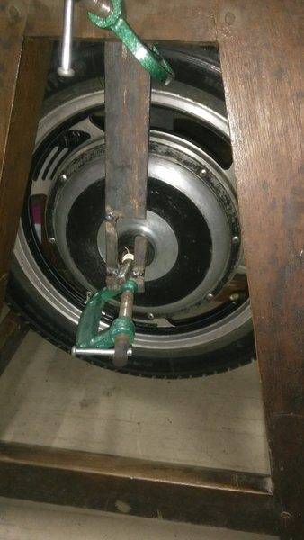

I have used in-wheel BLDC motor for my experiment. In this type of motor BLDC motor inbuilt on wheel. This wheel is a part of electric scooter. I wated to find the value of torque constant and back emf constant. Also how to measure torque for a selected current.
Please help me.

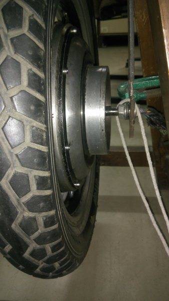

My hub motor is attached herewith.
