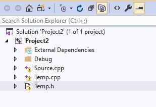

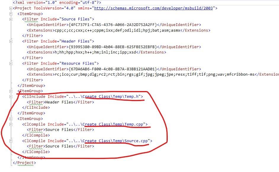

I tried. Now I do something funky, just follow what I did.
1) I created a new project and called Temp. I right click the Header file --> ADD --> NEW Item --> Header file which I named Temp.h. I then copy the header file from post 6 in.
2) I then right click the Source File --> ADD --> NEW Item --> C++. I called Temp.cpp. I copied the .cpp file from post 6 in. I then closed the Temp project.
3) I went into the folder of Temp project and copy both Temp.h and Temp.cpp into a new folder somewhere else. AND I DELETED the whole Temp project folder.
4) I then create a new empty project T1. I added the both Temp.h and Temp.cpp. like you described by ADD-->Exist file and search and add both of them. Making sure Temp.cpp has #include "Temp.h".
5) Then I right click Source File--> ADD --> New Item --> C++, I copied the Source file from post 6 in. I change to #include "Temp.h".
I ran and it failed.
Here is the snap shot of the Source.cpp that shows red wiggled line under #include "Temp.h".
Then I ran Ctrl-F5. This is the error message.
I circled on the right side that I have Temp.h in it.I double checked all 3 files and they look right.
I did these steps because as I described in post #33. There is always some strange things going on.
To verify this.
1)I DELETED T1.
2) Create a new project T2.
3) In T2, I ADD the Temp.h, Temp.cpp and Source.pp STRAIGHT from the folder I saved them in( the same as before). I make sure Source.cpp has #include "Temp.h".
4) Ran it, it works like a Champ.
You see what I did different between the two? If I copied everything into one project straight from the folder, it works. BUT, if I create a DIFFERENT project(T1) and ADD the Temp.h and Temp.cpp, then I copy the same Source.cpp in, it doesn't recognize the Temp.h.
I know this issue for a few days already, I just never bother to ask as I have asked too many questions here already. Again, thanks for your patience in keep helping me.
Thanks

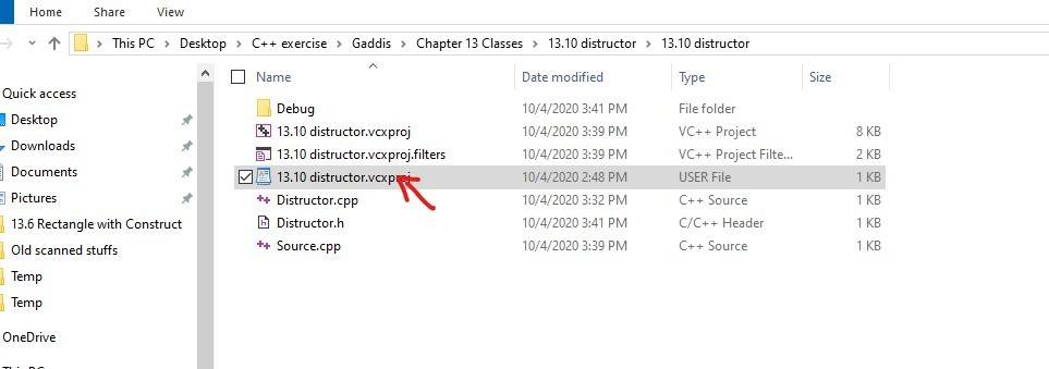

I did more-or-less what you described in post #38, and again, it worked just as it should.
The only thing I can see is that possibly the program structure as shown in VS doesn't match the actual file structure on the hard drive. You copied several files, but if you copied them to the wrong directory, VS is not going to be able to find them.
I created a new project named Temp. I then deleted the file that was in there, a nearly empty file named Temp.cpp. I copied Rectangle.h, Rectangle.cpp, and RectImpl.cpp as shown in the following screen shot of Solution Explorer in VS.
Here is a screen shot of the file structure, as shown in Windows Explorer.
The file structure should look like this:
Temp directory
... Temp.sln
... Debug directory (after a successful build, assuming your are in Debug mode). It should contain ....Temp.exe and a couple of other files used by the debugger.
... Temp directory (an inner directory with the same name as the outermost directory
... Two source code files - Rectangle.cpp and RectImpl.cpp, and the header file Rectangle.h
... Two or three files that VS uses - Temp.vcxproj, Temp.vcxproj.filters
I suspect that all your copying and deleting of files screwed things up so that VS can't find the files it needs to build the program.
Open Windows Explorer and see what your file structure looks like. If it doesn't look like what I've shown here, that's what's causing the error you see.

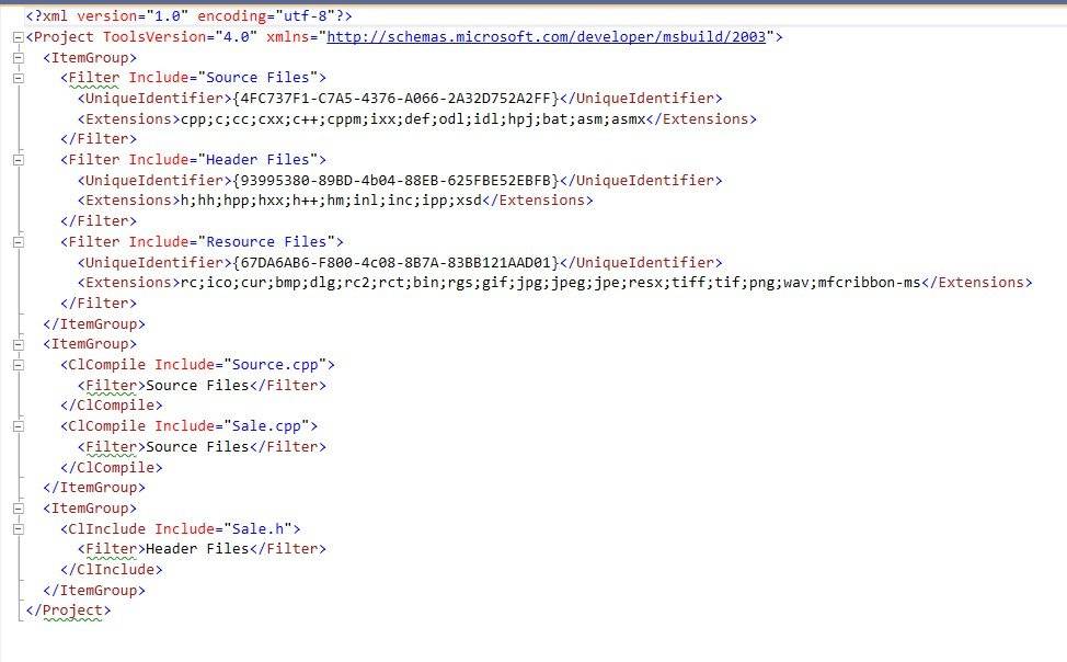

Hi Mark

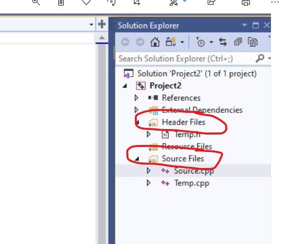

I created a Test folder that I stored the Temp.h, Temp.cpp and source.cpp from a WORKING program.
The difference is in the Temp project, I right click the Header files and ADD existing files and go to Test folder to get the Temp.h. Then I right click the Source file and ADD existing files and go to Test folder and get Temp.cpp.
THEN I open a NEW project T1, take in the source.cpp from the Test folder . I COPY to code of the source.cpp. I then go back to Temp project, ADD NEW file called source.cpp as the main file. Then I PASTE the code I copied from T1 in. It failed. It's the same code. Here are the 3 screen to show you the code of all 3 files.
Notice the red wiggle line?
This is the Temp.cpp the implementation file.
This is the Temp.h the Specification file
Now, this project is called Project2. I use ADD--> Existing file and go to Test folder to get ALL 3 files. It work like a champ. Mind you, in both Project2 and Temp above, the codes are EXACTLY THE SAME. Here are the screen shots of the 3 Project2 files. You can be the judge to compare the codes to verify:
  • #41
Let me sum it up my experience. In order for the program to work, ALL 3 files has to be created the same way. Like in project2, I use ADD existing file and go to Test folder to get all 3 files.
In Temp project that failed. I use ADD existing file and go to Test folder to get only Temp.h and Temp.cpp. THEN in order to make the source.cpp coming from a different place. I created a new project T1 just to get the source.cpp into the project, THEN just use Ctrl-C to copy the code. Then I go back to Temp, ADD--> New-->.cpp to create a blank source.cpp. Then I Ctrl-V and copy the code into it. It failed.Like I said, this is not new to me, a few days ago I did 3 exercise, first exercise is to create 5 structures with data in each of them. The second exercise is to read the 5 back. They are work. The 3rd exercise is to read the 5, choose to change one of them. IT FAILED. Even if I copy the binary file from the first exercise to the folder of the 3rd exercise, it FAILED.
I finally had to just copy and paste the code from the first exercise into the 3rd exercise, run the code to create the 5 structures store in the folder of the 3rd exercise. Then delete the code. Now I can read and change anyone of 5 as will.
This is NOT new to me. that's why I know how to make it fail. All I have to do is to have the source.cpp created from a different source from the Specification and Implementation files, it will fail.
Different source is just copy into another project first, then copy over. Just that simple.
thanks

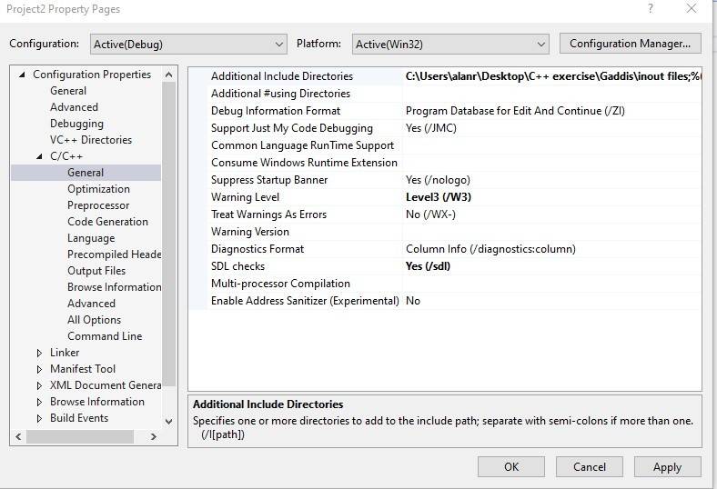

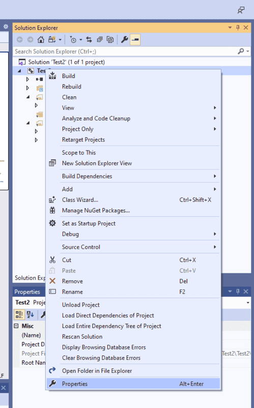

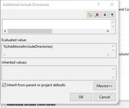

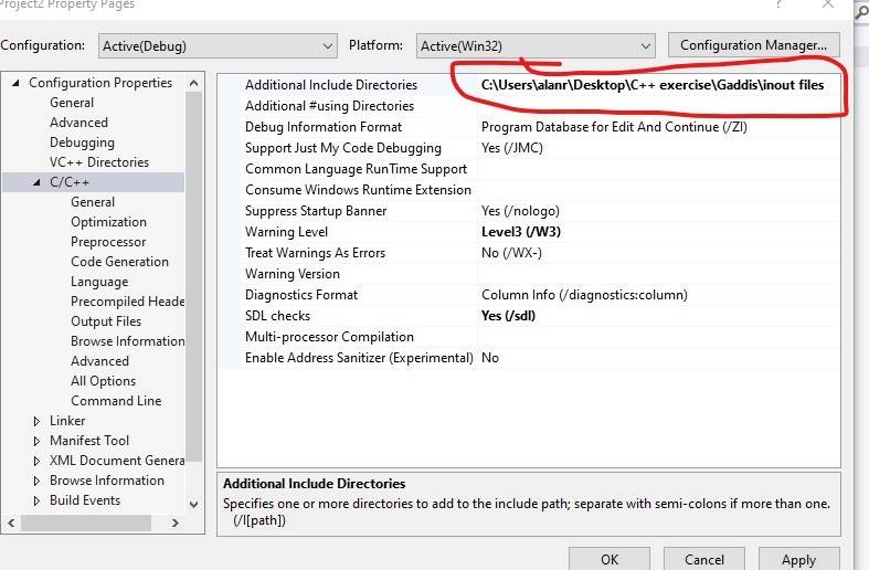

If you #include "x.h" in a source file, then either x.h needs to be in the same directory as that source file, or you need to tell the compiler where to look for header files by adding to the list of include search paths.
It makes sense that you would have the error if the source file is in one place and the headers are in another, and visual studio is not generating the compiler arguments to add the location of the headers to the search path. You can manually add those directories to the search path as I pointed out in previous posts. You can look at the actual compiler command and see if the include search path was added.
https://stackoverflow.com/questions...-the-build-command-line-used-by-visual-studio
You would think "add existing file" might automatically trigger VS adding a new include directory to the search path if necessary.
Maybe some of the answers here will help as well. I noticed the last one suggests individual cpp files might have their own properties (e.g. additional include directories) separate from the project properties. Or maybe you added the file only for release or debug mode instead of for all configurations.
https://stackoverflow.com/questions/3790632/visual-studio-does-not-honor-include-directories
Or Mark mentioned something about setting up a "common" directory. I don't know the way people are supposed to handle this in VS exactly.
Also, don't mistake the folders in VS for real folders. The files have an actual location on your computer, which is what actually matters.

Hi Mark
I don't mean to be offensive. I know what you mean about looking at the file explorer. I am going to post the screen shot of both the Project2(working) and Temp(not working) later.
I don't think you read my description carefully enough. My whole point is if the source.cpp are from different places where the Temp.h and Temp.cpp come from, it won't work even if you read them, they are IDENTICAL.
I describe in detail TWICE already, first in post 38, then again in post 40 and 41, in very detail how I created the two project. I show you in post 40 that on the right side, you see all 3 files there. AND if you click anyone of them, you can SEE the codes of EACH of them. They are there. I screen shot all 3 codes in both Project2 and Temp, you can see they show EXACTLY the same. One work and one doesn't Please look at them again. How can this go so wrong if I went through all these to show they are there?Regarding to what you ask. I looked and NONE of them have the Temp.h and Temp.cpp. The working one Project2 don't even have source.cpp. They are so far off I did not even mention it. Here are the screen shot, both are wrong according to you, I have no explanation why Project2 work.
Here is the Temp that DOESN'T work:
Here is the Project2 that WORKS.
You see the Project2 doesn't even have a single file? BUT IT RUNS.

I went back and look at the old folders, those I created as described in post #30 all have source.cpp, Rectangle.h and Rectangle.cpp in the file explorer. I redo a new project, BUT instead of ADD--> Existing and load the file. I COPIED those codes, using ADD-->New and paste them in. It works and in file explorer, it shows all 3 files like you want to see.
WHY? Why it won't show if I do ADD-->Existing and navigate to another folder to get the file? Why it has to be copy and paste? the method I used in post 30 all needs to be copy into the newly created blank files. Both ways, you can see the files are there, you can click and see their codes. Why?

Did you find the "additional include directories" property for your project, and for your source files individually?
  • #52
Before I start digging into the file stuffs. I ran more experiments based on looking at the file explorer and to find out why the files don't show up when Project2 works.
This is what I did. With Project 2 that I use ADD-->Existing file to go to Test folder to get those files. I went to Test folder and temporary deleted the Temp.h. Project2 FAILED to compile. This means the Project2 NEVER pull in the files, just by reference(if that's the right word). That might be the reason why it doesn't show up in file explorer.
If I do copy then ADD-->New, You will see all 3 files in the file explorer like what Mark show.
So the result is, either I do all ADD-->Existing for all 3 files, OR ADD-->New and copy the codes for all 3 files. They BOTH WORK. BUT if I mix some ADD-->Existing, some ADD-->New and copy, it FAIL.
Why?
This go beyond digging through the files and all. VS obviously gives the provision of ADD-->New and ADD-->Existing. How come there is limitation? Checking into the files ONLY shows the result/symptom, WHY ADD NEW and ADD Existing cannot be combined? This is more troubling to me.
Now, I am going to look into what Jarvis said. I still don't believe they are the same.

Because the source file needs to be in the same directory as the include file, or the "additional include directories" of the source file needs to have the directory where the header files added.

Until you figure that out, you're just wasting your time. It's like you keep walking into a closed door because you refuse to listen when someone tells you how to open it.
I deleted the video because, although it shows how to organize h and cpp files separately, the author added the path to his "src" folder in the "additional include directories", which I think doesn't make sense and could lead to confusion about how things actually work.
VS apparently allows you to set different "additional include directories" for each cpp file. This makes sense, because you might have different header files in different places with the same name, and need to control which one is included by which cpp file. VS designers had to make a choice what the default behavior is in different cases. I guess the way you are using it, the default is to NOT add the path to the header file in the "additional include directories" property of the cpp file. So you have to do that manually, or you have to figure out how to change the VS default, or do things a different way so that the default is what you wanted.

After a search, I found that the "additional include directories" option is in the C++ General tab for VS 2019.
https://docs.microsoft.com/en-us/cpp/linux/prop-pages/general-linux?view=vs-2019

My questions are why Project2 works without any of the files in the project folder then? I use Add-->Existing that doesn't actually pull the files in.
For a project named Temp, VS keeps track of where all the files are in a file named Temp.vcxproj. This is a text file, so you can read it. It's not a good idea for you to edit it, if you don't know what you're doing. You can find the .vcxproj file for your project in the 2nd-level directory for your project, which will normally have the same name as the top-level directory.
