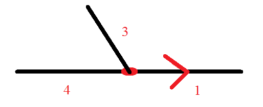

Aha At first I was still confused then I realized that member 3 would be in tension since the arrows of both 1 and 4 point to the left. Would 7 be compression then? Since it has one y component over the axis pointing down (6) and two (9 and 7) below, the ones below have to point to the joint to balance it? Is it a logical way to think about it? Would 5 then be in compression too?
Edit: Or they're just zero... I thought that but you said five isn't zero so...

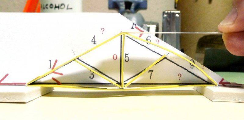

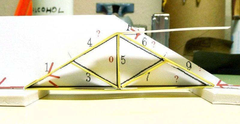

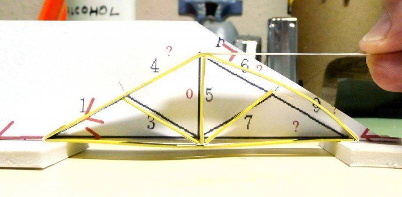

Vicinity 24, Since I could not resolve the issue of trusses 3 and 7 in figure 4, I decided to do what I would have done during 20 years of doing product development and testing, make a model, load it and see what happens. Being able to do this type of thing is why I enjoyed almost every day of my 45 year engineering career.
As you can see in the below photo sequence the final answer is: Truss 3 is in compression (this can be implied by the slight displacement to the right of the top of truss 5) ; and, Truss 7 is (had it been permanently attached it) in tension. (The truss assembly is permanently attached to the left end block and free to slide on the right end block.)

The bowing of your model truss means that truss has a bending moment. Truss analysis assumes only tension or compression in a truss; no moments. I believe 3, 5, and 7 are "0" trusses. Unlike real truss members, ideal trusses cannot fail in a buckling (bending) mode, as your model did.
If it is assumed that the truss members are ideally rigid under both tension and compression loads, then all triangles are perfectly rigid; and, I agree with your conclusion that 3,5 & 7 would be "0" trusses.
