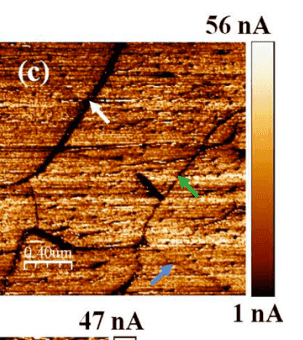

When Prof. Hones says "stitched together", I believe he means in terms of grain boundaries. This white arrow is pointing to a grain boundary in this image from Ahmad, M. et al. that would not be considered "well-stitched"

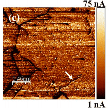

whereas the white arrow in this image from the same authors is pointing to a grain boundary that would be considered "well-stitched"
The grain boundaries occur due to the nature of CVD in which the precursor gas will adsorb onto the surface and nucleate, where these nucleation boundaries meet other nucleation boundaries is where grain boundaries will form.
