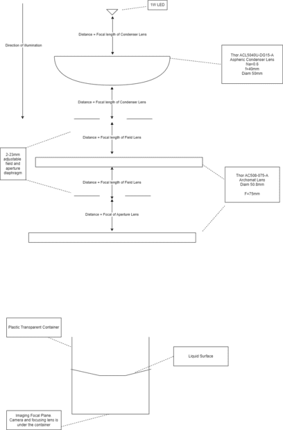

I have attached the diagram of the illumination. Please let me know if that helps.
To clarify the illumination area is much larger than the diameter of the container. The illumination can access areas outside of the container, however the issue is that the centre of the container liquid is nice and bright but the edges are dark, as if the illumination was not as bright there or the image of the illumination generated by the liquid surface working as lens was too small for the imaging system.
Hence the question - how can I measure, calculate that? Or alternatively what other lens is needed to mitigate the lens generated by the liquid surface....

It seems that the direction of light is down, so it is an inverted scope?
If that is true then your drawing appears to show the water container with a non-flat bottom.
If that's the case, it will act as a lens when it has water in it, but not without. Adding more water in the tube could end up reducing the overall difference in OD between neighboring paths.
Most plates made for inverted scopes have flat bottoms to avoid this problem.
The water has a significantly different optical density from that of air, so the light bends.
This might be correctable by flooding the tube's surroundings with water. This might be doable by placing the tube in a water containing petri plate on the microscope stage (depending on how you are doing things). This should remove a lot of the difference in optical densities between paths near the edge, by replaceing air with water.

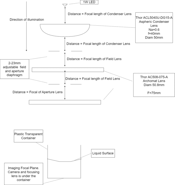

Apologies for the poor quality of the image, seems like upload to the forum downscaled it. I tried to increase the font to make it more readable:
To summarise, yes this is in essence inverted microscope. The illumination is from the top, camera is located below and focusing on the bottom of the container. The bottom of the container is mostly flat, as much as plastic moulding allows. The lensing effect seems to be done by the top surface of the liquid. To be fair I am not even sure if that surface is working as concave or convex lens at this point.

Gleb1964 said:
4f Koehler transmission illumination I think picture is illustrated 4f Köhler illumination described
Yes that is pretty much what I am using here for illumination and I can prove that the beam of light is mostly parallel when it comes out from the illumination system. Then the light seems to be bent when it goes from air to liquid inside the container.

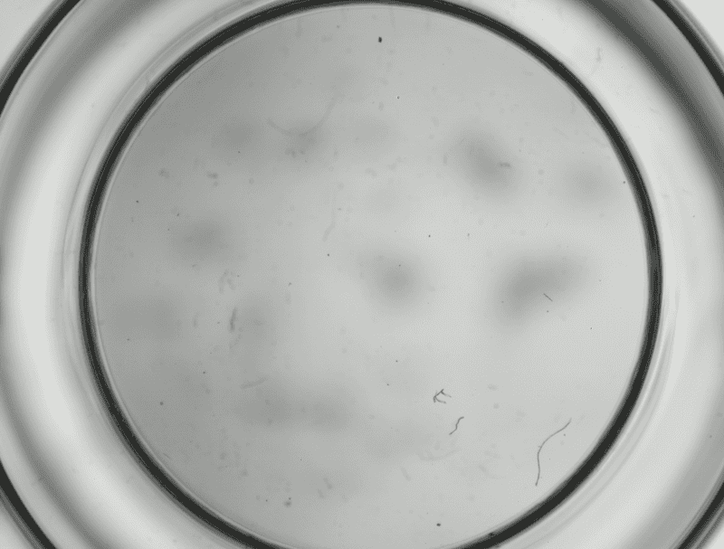

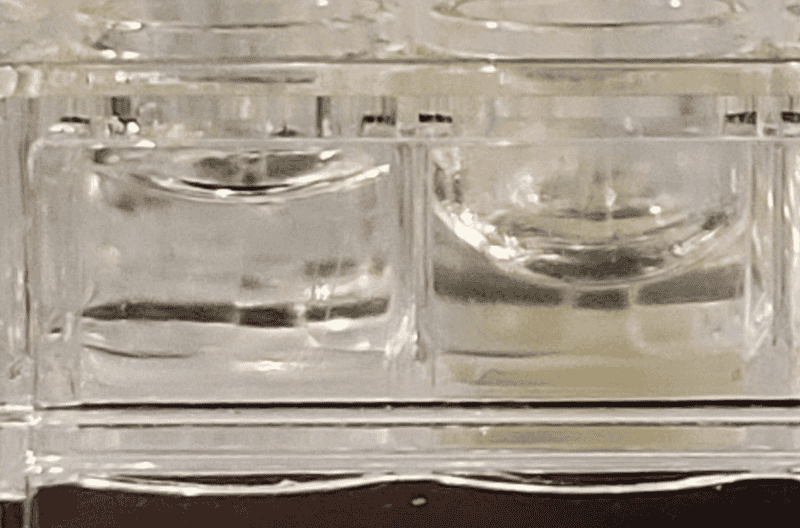

Many thanks for some good replies. To put things into context please see that image below taken from the side of the container showing how the liquid bends inside.
The illumination is from the top and imaging is below.
The system is telecentric, the center of illumination is at the center of the container, imaging lens and the camera.
And here are example images with 200 ul (showing the issue) and 400ul of liquid which is the container filled up to the top.
All parameters of the system are this same other then the level of liquid in the container.

Interesting. It looks to me like the meniscus is, essentially, a negative lens. The surface forms small angles near the center and larger angles as we move outwards, meaning the light is entering close to normal and hardly refracting at all near the center but being very sharply refracted near the edges. That should explain why the illumination is so uneven. The 400 ml sample has a much shallower meniscus and is roughly twice as far away from the bottom, which would help even out the illumination.
I'd guess that placing a positive lens somewhere before the meniscus-surface would counteract the effect somewhat. I'm unsure if it can be eliminated entirely.
I also wonder if a diffuse light source instead of a collimated source would help. Though that might affect the quality of the dust particles in the image.
Again, just my non-professional thoughts.
