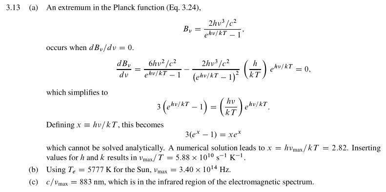

I'll include two pictures; the first one is the question from the book and the second one is the answer from the solution manual. I have no idea how they got that answer. For part a, the solution says that you can't solve it analytically, so you have to solve it numerically. What does that mean? You just make up numbers to put in there? There is no value for T to put in and no value for Vmax to put in, yet they somehow get 2.82 as the answer. To get that answer, for part a, they must have put in a value for Vmax, which is what we're trying to solve for, and put in a value for T, which has no value yet.
Are you comfortable with the derivation of the third equation, which is the condition that has to be satisfied in order for the derivative of B with respect to ν to be equal to zero (for any arbitrary value of T)?
Chet
Yeah, I derived all the way to the end on my own without using the solution manual, and got the same result they did. But after looking at it, it doesn't look like they actually did input numbers for V and T, which makes me wonder where the 2.82 came from. I tried solving for x, with x alone on the right side, and putting in various values for the x on the left side (the x's that are in the exponents of e), and it seems to approach 3 the higher I go. I don't know what that means, though.
You don't need to input numbers for ν and T. If you look at the third equation carefully, you will see that the same combination of parameters appears in all three places in the equation. They define this combination of parameters as x. Once you know that value of x that satisfies the equation, you can determine the value of ν that makes B maximum for any arbitrary value of T. That value value of ν is given by:
$$ν_{max}=\frac{kT}{h}x$$
To find the value of x, you need to solve the non-linear algebraic equation involving x. I can see that you started trying to solve the equation by using a so-called successive substitution approach, which was a good idea. But, not all successive substitution algorithms converge to a solution. Some of them diverge, and, the one you chose obviously diverges. The usual way of solving a non-linear algebraic equation like this is to apply Newton's Method. Are you familiar with Newton's Method?

I graphed the equation in wolframalpha and it gave me a graph that intersects the x-axis at (0,0) and at what looks like (2.8,0). I then took the derivative of the 3rd equation by putting everything on the left side of the equation, leaving 0 on the right side, used that in the Newton's Method formula, input 2.8 in place of x, and got an answer of 2.71215. Is that the value of x?
Thanks for the response.
edit: Ok, I jumped the gun a little. So that's the first iteration. Since 2.8 and 2.71215 aren't the same, that means I need to do it again, using 2.71215 instead of 2.8. I'll post the results in an edit.
edit: Ok, I just did that and my next iteration was 2.404, which is getting farther away from 2.8, which I don't think is supposed to happen.

Ok, I'm redoing it because I made a mistake deriving it, but here is the Newton's Method formula I'm using:
X_{n+1}=X_{n}-\frac{f(X_{n})}{f'{(X_{n})}}
Here is my
f(X_{n}) = 3(e^{x}-1)-xe^{x}
And my
f'(X_{n}) = 2e^{x}-xe^{x}
After doing it again with the correct derivative, I got 2.8219 as the answer for x, which is pretty close to the starting 2.8. If it repeats, then that will be my value for x.
Ok, after continually doing it, it's converging to 2.82. Seems like this worked, thanks a lot.

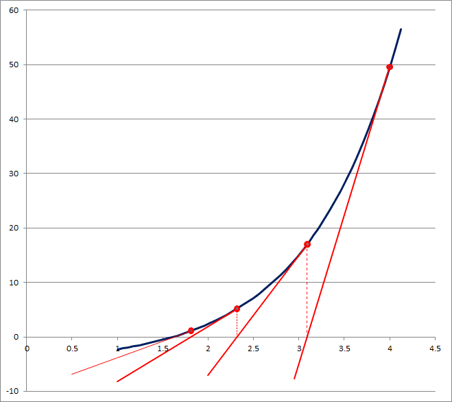

A small rectification: Newton is not a root bracketing method (like bisection or regula falsi)
Simple counter-example: ##f(x) = e^x - 5## starting from ##x_0## = 4:
Code:
Iter          x                     f(x)
0           4                   49.60
1           3.092               17.01
2           2.319                5.16
3           1.811                1.114860
4           1.628                0.09573
5           1.609616601          0.00089
6           1.609437928          8.0E-08
ln(5)       1.609437912
And perhaps some more info: Newton-Raphson is very widely used.
Regula Falsi and secant methods amount to NR equivalents but with (initially coarse) numerical derivatives (so they end up in digital noise if you're not careful).
Newton converges very rapidly once going (roughly doubles the number of significant digits per iteration). If it converges. Contra-indications are: wrong sign of ##f'## or (even worse) ##f'(x_0)=0##. So you want to have good derivatives and start near a solution. Maybe by starting off with one of the other, more robust methods.
