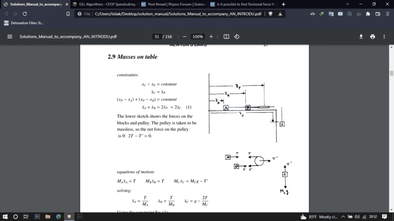

image of the system attached below, there's no friction.
##L=E_k-U+T \alpha##
I had used the same constraint as the solution manual says.

mcconnellmelany said:
##L_1=\frac{1}{2}m_A\dot{x_A}^2+\frac{1}{2}m_B\dot{x_B}^2+\frac{1}{2}m_C\dot{x_C}^2+m_Cgx_C+T(x_A+x_B+2x_C-c)##
whereas c is just a constant.
The last term appears to me to have a sign error. Shouldn't the ##+2x_C## be ##- 2x_C##?

TSny said:
The last term appears to me to have a sign error. Shouldn't the +2xC be −2xC?
My constraint was ##x_p-x_a+x_p-x_b=c##
##2x_p-c=x_a+x_b##
Ohhh there's a sign error. It should be ##T(x_a+x_b-2x_c+c)##
