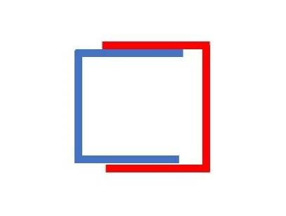

The following two charts should define a smooth atlas for the square (note the two regions of overlap are open)
Anyway I believe it is not the 'restriction' of the ##\mathbb R^2## smooth structure just because the square is not a submanifold of ##\mathbb R^2##
Any comment, is that correct ?
