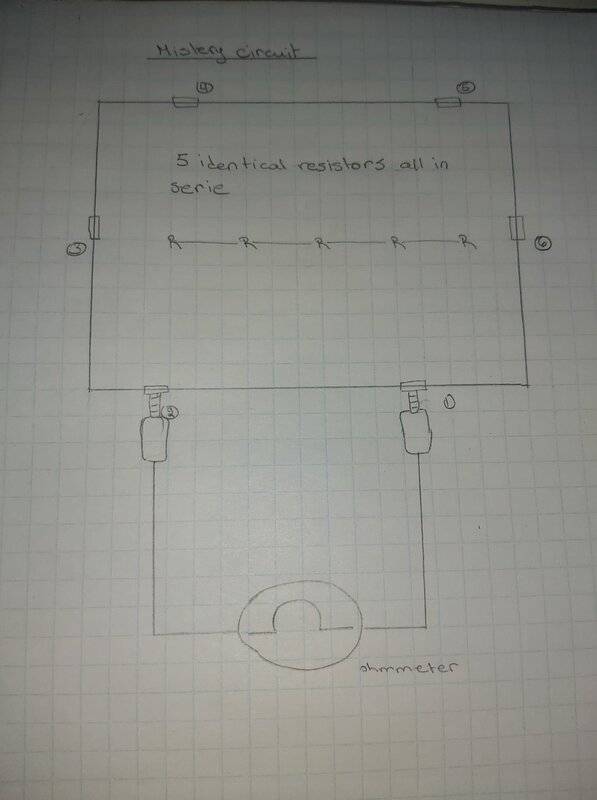

deduct the value of each of the 5 resistors of the same value in the 2 black boxes and their organization in a circuit explaining what is being measured.
Serie: Req= R+R+R...
Parallele: 1/R_eq =1/R+1/R+1/R….
How can I solve a ciruit mystery box only knowing there are 5 identical resistors inside. I have two boxes to solve, one they're all in serie and the other is a combination serie and parallele. Each mystery box has 6 nodes and i can connect 2 nodes at a time to an ohmmeter.
If i take the one all in serie (it's the only one I've started) this is what I've concluded:

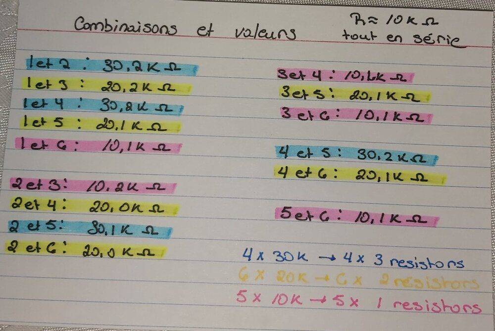

All resistor are 10k ohm and they're all in serie. With 6 nodes i have the 15 following combinations. What other conclusions could be made? The colors are because I'm more of a visual learner.

Measure and record the resistance between;
Terminal; t1 and t2=30k, t3=20k, t4=30k, t5=20k, t6=10k
Terminal; t2 and t3=10k, t4=20k, t5=30k, t6=20k
Terminal; t3 and t4=10k, t5=20k, t6=10k
Terminal; t4 and t5=30k, t6=20k
Terminal; t5 and t6=10k
Notice the 5x 10k ?
The 5x 10k resistors are between; t1-t6, t2-t3, t3-t4, t3-t6, t5-t6.
Notice there are three arms from t3 and from t6.
But t3 and t6 are connected by 10k.
t2 and t4 are each connected by 10k to t3.
t1 and t5 are each connected by 10k to t6.
t1, t2, t4 and t5 are the terminal ends of the circuit.
Now check all the 20k and 30k values are series connected paths on the same diagram.This is what I’ve been tryng to do with those info:
The one in the bottom I'm tryng to see if 2 nodes can be connected at the same place/switch but I am still blocked...

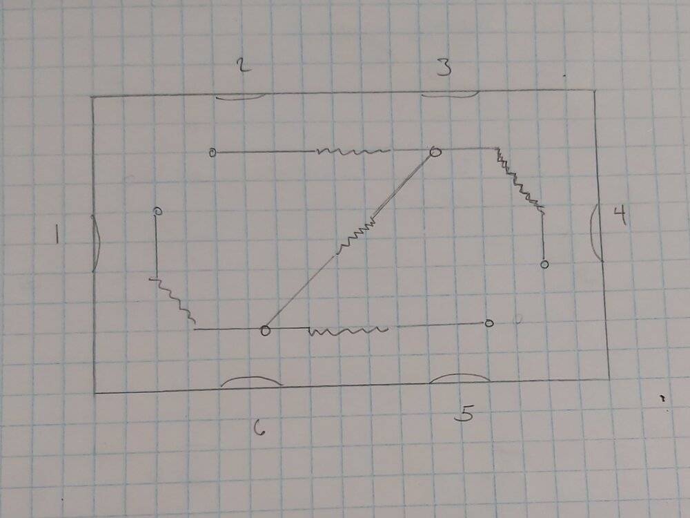

You noticed that there were 5 10K measurements. What does that suggest about any internal nodes (nodes not connected to the outside of the box)?
There are 5 10K readings. That should be a big hint.
These resistors are not lined up like this: -R--R--R--R--R-
Also, none of the measurements indicate an open circuit, so everything is connected - directly or indirectly.
That's what i was suspecting...this is what i have if the resistors are not lined up like this: -R--R--R--R--R-
But doesn't that resistor between 3 and 6 make the circuit parallele? I opened the circuit at 1, 2, 4, and five for that but I'm not sure.
There are no parallel circuits between any 2 terminals in the illustration.

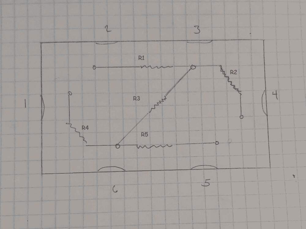

Given the measurements listed, the circuit as cannot be as illustrated here. For explanatory purposes, the illustration is here re-posted with the resistors (arbitrarily) labeled R1 ##-## R5:
(edited to emend this part, as it had errors, and the errant vesion is quoted and discussed below).
sysprog said:
There are no parallel circuits between any 2 terminals in the illustration.Given the measurements listed, the circuit as cannot be as illustrated here. For explanatory purposes, the illustration is here re-posted with the resistors (arbitrarily) labeled R1 ##-## R5:
For example (using ##\leftrightarrow## to mean 'is connected via ammeter to'), if ##\mathtt{T1\leftrightarrow T3 = 20k}##, then ##\\##
##\mathtt{R1=20k}##, and if ##\\##
##\mathtt{T1\leftrightarrow T4 =30k}##, then ##\\##
##\mathtt {R3+R4=20k}##, but if ##\\##
##\mathtt{R1=20k}## and ##\mathtt{R3+R4=20k}##, then ##\\##
##\mathtt{T1 \leftrightarrow T2 = R1+(R3+R4) =20k+20k=40k}##, ##\\##
but the measurement says that ##\\##
##\mathtt{T1 \leftrightarrow T2 = 30k}##, ##\\##
so we have a contradiction.
Hum I am afraid to be wrong but it works everytime i try. Taking your example, how is R1=20k R1 is between t2 and t3 not t1 and t3.
Plus there is no way only one resistor is 20k, they are identical and 10k
I was still editing when you quoted me (I missed some things while using Preview), and I recognize that the problem statement says the resistors are all of equal value, but the connection from T2 to T3 inccludes only R1, so if they're all 10k, how do you get a measurement of 20k from T2 to T3 ?
Haha Haha that's what I am saying t2 to t3 is 10k lol
oops ##-## my mistake ##-## sorry . . .
So is it right? I am confuse now haha
I'll have to review more carefully before I can in good conscience reply to that question.
(edit)
I looked again, and it now looks right to me. I can't not have said what I said, but I can admit that I was hasty, and that my statement that "given the measurements listed, the circuit cannot be as illustrated here", was as far as I can now tell, incorrect. Sorry about the accidental incorrectness.
