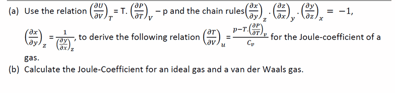

I have the following task:
Typed problem part (a): show that (dU/dV)_T = T(dP/dT)_V - p, using the chain rule with partial derivatives and the identity (dx/dy)_z (dy/dz)_x (dz/dx)_y = -1, to derive (dT/dV)_U = (p - T(dP/dT)_V)/C_V for the Joule coefficient of a gas. Part (b): calculate the Joule coefficient for an ideal gas and a van der Waals gas.
I already managed to do a), but how do I solve b) ? What is this Joule-Coefficient and how can I calculate this for the two different kinds of gases without any given values?

The equation for the Joule-Coefficient is given in the problem statement. Are you asking what it means physically?
As far as the two different kinds of gases are concerned, you are supposed to do it algebraically. For an ideal gas, I assume you know PV=nRT. Do you know the P-V-T equation for the van der Waals approximation to real gas behavior?

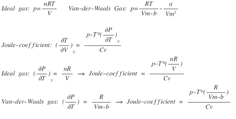

Hi,
Does this mean, that I have to do it like this:
Handwritten-style worked derivation of the Joule coefficient for ideal and van der Waals gases: equations of state, (dT/dV)_U = (p - T(dP/dT)_V)/Cv, and substitutions giving simplified expressions for each gas.
And now just simplify?

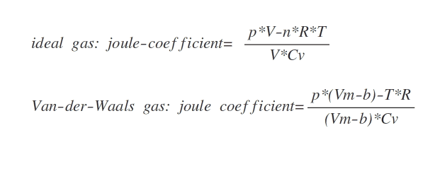

Is this already the result, or can I simplify it even more?
Two formulas for the Joule coefficient. Top, ideal gas: joule-coefficient = (p*V - n*R*T) / (V*Cv). Bottom, Van-der-Waals gas: joule coefficient = (p*(Vm-b) - T*R) / ((Vm-b)*Cv).

If pV=nRT, what is pV-nRT equal to?
If ##p=\frac{RT}{V_m-b}-\frac{a}{V_m^2}##, what is ##p-\frac{RT}{V_m-b}## equal to?

-a/(Vm)^2
And this means the coeficient is in the upper case 0 and in the lower case -a/(Vm)^2 and therefore these are the final results?
krootox217 said:
-a/(Vm)^2
Yes, but don't forget to divide by Cv.
Oh I nearly forgot, thank you!
This means it is in the first case still 0 and in the second case -a/((Vm)^2*Cv)
