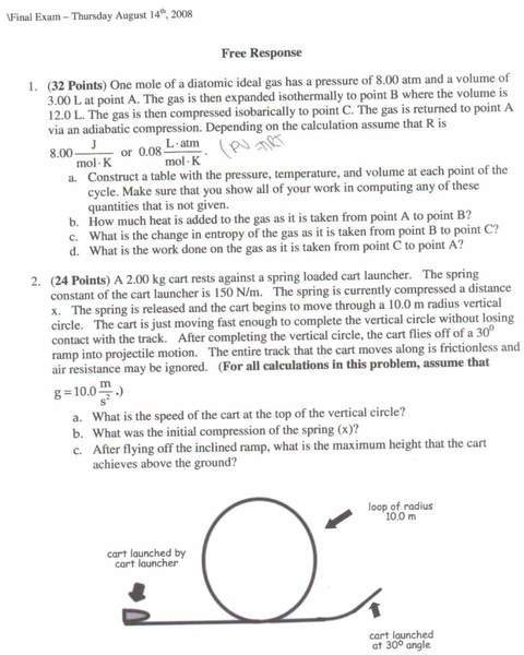

The problem is on the attachment. I can't seem to find the volume or temperature of T. If someone can tell me how to find them i can do the rest of the problem. Any help would be greatly appreciated.
on the attachment

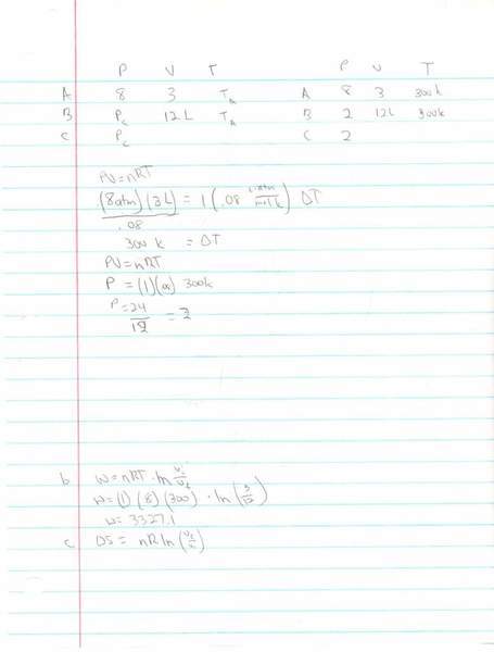

You say you can't seem to find the volume or temperature. What have you tried? What equations did you start from?
i used the PV= NRT
I can't find the Volume and Temperature of point C only.

Well the problem is
One mole of a diatomic ideal gas has a pressure of 8atm and a volume of 3 L at point A. The gas is then expanded isothermally to point B where the volume is 12 L. The gas is then compressed isobarically to point C. the gas is returned to point A via an adiabatic compression. Depending on the calculation assume that R is 8 J/Mol (K) or .08 L atm/ mol K
I can see the attachments now. You are given the volume, pressure, number of moles and R. Can you find the temperature at point A?
yes i found the temp of A and B because they are the same since they are isothermal. knowing that i could find the Pressure of B and C because they are isobaric, but i can't find the volume or temp of point C.
OK. Now there is an equation that relates point A to point B and one that relates point A to point C. What are these equations?
I don't know what equations and how do they relate? by going back to a via adiabatic process doenst that mean no heat is transferred?
Yes, adiabatic means no heat is transferred. Also, for the adiabatic process,
pAVAγ = pCVCγ
where γ = CP/CV
Find γ for a diatomic gas, then use this relation to find VC.
Use the relation I gave you earlier to find VC. You know everything else. Once you have VC, you can find TC.
i get Vc^1.4= 42.8 how do i solve that? can anyone else help?
You can rewrite 1.4 as 7/5. You get
VC7/5=42.8
Raise both sides of the equation to the 5/7 power. This gives you
(VC7/5)5/7=42.85/7
Can you get a number for VC now?
