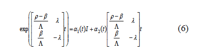

Please help me understand the following step
When ## a ## is just a real number, one can use a Taylor series to represent ## e^{at} ## as
## e^{at} = \sum_{n=0}^{\infty} \frac{(at)^n}{n!} = 1 + at + \frac{1}{2}(at)^2 + \ldots ##
By analogy, one can define the exponential of ## \mathbf{A}t ##, where ## \mathbf{A} ## is now a matrix, as
## e^{\mathbf{A}t} = \sum_{n=0}^{\infty} \frac{(\mathbf{A}t)^n}{n!} ##.
Because multiplying a matrix by itself is perfectly well defined, the above sum makes sense. Now if ## t ## is not too large, we can truncate the series and write
## e^{\mathbf{A}t} \approx (\mathbf{A}t)^0 + \mathbf{A}t \equiv \mathbf{I} + \mathbf{A}t ##,
where ##\mathbf{I}## is the identity matrix. Using this truncated sum, your formula can be derived, except for the time dependent functions ##\alpha_1(t)## and ##\alpha_2(t)##. Perhaps someone else can shed some light on where those might be coming from. What is the context in which you are seeing this equation?
Likes jim mcnamara
Geofleur's infinite series is the place to start. The trick is to use the Cayley-Hamilton theorem, which tells you that a matrix satisfies it's own characteristic equation. Sine you have a 2x2 matrix this is a second order polynomial, so you can write ##\mathbf{A}^2=\alpha_0 \mathbf{I} + \alpha_1 \mathbf{A}## for some ##\alpha_0## and ##\alpha_1## . It follows that any power of your matrix can also be represented by a linear combination of ##\mathbf{I}## and ## \mathbf{A}##. Hopefully that shows you where the result comes from.
This is a common approach used in electrical engineering.

Thank you so much for your help!
