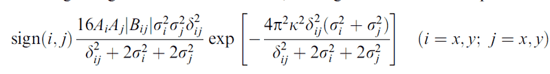

Where , rho 1 and rho 2 are two dimensional position vectors and K is a two dimensional vector in the Fourier domain. I encountered the above Eq. (27) in an article and the author claimed that after integration the right hand side gives the following result:
I tried to solve this integral but couldn't get it right. please can anyone here can guide me how to get this result from Eq. (27).

If it weren't for that factor ##Sign(i,j)## in the result I would have thought that we could treat ##\sigma_i##, ##\sigma_j## and ##\delta_{ij}## as arbitrary constants in (27) and that you were simply trying to find the Fourier transform of a multivariate Gaussian (which I would do by diagonalizing the quadratic form to get a bunch of 1-D Fourier transforms of Gaussians, which can be performed many ways). But it seems like something else is going on here.
So I think we need more information. What do ##\sigma_i##, ##\sigma_j## and ##\delta_{ij}## stand for, and what is ##Sign(i,j)##?

Hi thanks for the reply. The parameters ##\sigma_i## and ##\sigma_j## corresponds to the spread of spectral density and ##\delta_{ij}## is the width of the correlation between the i and j components of a field. and sign (i, j) = 1 when i = j and sign (i,j) = -1 if i is not equal to j.

Okay. I think I get it now. We can treat the parameters as constants, but the final simplifications can take into account that the answer will depend on whether ##i=j## or ##i\neq j##.
What part are you getting stuck on? Can you do the integrals and are just struggling with the algebra to simplify the expression, or are you having trouble doing the integrals? I've derived a simple expression for the general integral, but have not done the messy algebra to see if the final result agrees with the posted answer.

I am struggling with the doing the integrals. I tried and tried but couldn't get the result.
Okay. By the way, my "simple" formula I thought I had was wrong. The correct way is messy algebra, but conceptually quite simple.
The basic form of your integral is:
I = \int_{-\infty}^{\infty} d^2\mathbf{r}_1 \int_{-\infty}^{\infty} d^2\mathbf{r}_2\, e^{-i2\pi\mathbf{k \cdot }(\mathbf{r}_1-\mathbf{r}_2)} \, e^{-\mathbf{r}_1 \cdot \mathbf{r}_1 /a_1^2}\,e^{-\mathbf{r}_2 \cdot \mathbf{r}_2 /a_2^2}\, e^{-2 b \mathbf{r}_2 \cdot \mathbf{r}_1 }

This can be integrated using the same trick above. The algebra will be really messy, but this is do-able. Hope this helps!
Jason
I have another way that yields a simple result that may be easier to deal with. I will use matrix notation, so dot products will be ##\mathbf{k \cdot x} = \mathbf{k}^T\mathbf{x}## where the T superscript represents transpose.

Now, ##\mathbf{s}^T\mathbf{s} = -4 \pi^2 \mathbf{k}^T B P \Lambda^{-1/2}\Lambda^{-1/2} P^T B^T \mathbf{k}=-4 \pi^2 \mathbf{k}^T B A^{-1} B^T \mathbf{k}##. So we finally have
\begin{eqnarray}
I = \pi^2 \left| A \right|^{-1/2}e^{-\pi^2 \mathbf{k}^T B A^{-1} B^T \mathbf{k}}.
\end{eqnarray}

Thank you so much for the great help and giving priceless time to guide me in solution of this integral. I am trying to solve it with the approaches you mentioned. I hope I can find a reasonable solution to this integral. I also tried to solve the integral with using the formula, integral (exp(-bx^2) exp(iax))dx = sqrt(pi/b)exp(-a^2/4b) but I couldn't get the required result.
Did you try the approach I gave in post 7? When i plug in the parameters of your problem into equation 20 I get a result that is almost the one you posted. Instead of ##sign(i,j)## I get ##\pi^2##.
In retrospect I do not understand how the sign factor could possibly appear. For the special case ##\kappa=0## you have an inyegral of a Gaussian, which must be positive. Likewise, it seems inevitable that there should be a ##\pi^2##. So i do not see how your posted solution would be correct.
