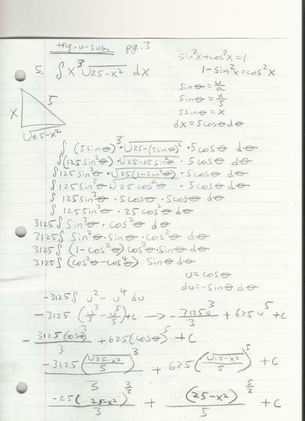

I must have some error with my algebra then. My final answer for my trig. u-sub. problem is wrong.
for:
∫(x^3)sqrt(25-x^2) dx
I know have:
-125*((5*((1/5)*sqrt(25-x^2))^3-3*((1/5)*sqrt(25-x^2))^5)*(1/15))
when I simplify this my answer is wrong.

How does your original problem relate to this integral that you have to solve? For such an integral, you should be looking to make a u-substitution such that the square root will be gone. Using
[tex]x=5\sin{u}[/tex]
or
[tex]x=5\cos{u}[/tex]
will achieve this

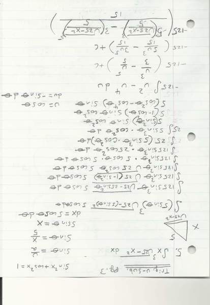

I figured I'll send this real quick before I turn off the PC.
This is the work I have done.
Sorry, I just realized it's upside down. Didn't mean to do that.
If you have issues with it let me know. I'll resend 1st chance I get.
The mistake you made was turning
[tex]125\sin^3{\theta}\times 25\cos^2{\theta}[/tex]
into
[tex]25\left(5\sin^3{\theta}\times\cos^2{\theta}\right)[/tex]
You're factorizing as though we're adding two values, but we're not, we're multiplying.[tex]125\sin^3{\theta}\times 25\cos^2{\theta}[/tex]
[tex]=125\times 25 \times\sin^3{\theta}\cos^2{\theta}[/tex]
[tex]=5^5\sin^3{\theta}\cos^2{\theta}[/tex]
If you have something like
[tex]a\cdot x\cdot a\cdot y[/tex]
then this is equivalent to
[tex]a^2xy[/tex]
then if you factor out 'a', you'll only be taking out one of the factors of a, hence [itex]axay=a(xay)[/itex] and not [itex]a(xy)[/itex]

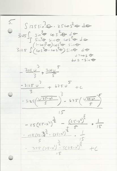

I did this in hast, Can you please check it over?
Wait, I think I should've done all the work in the parenthesis first. Sorry things are hectic. I'm trying to do my homework and meanwhile my mother could care less and has me scrambling to go visit some relatives for the holiday.
I'll redo and re post as soon as I can.
It's pretty hard to follow what you've done to be honest. At the point where you substitute f(x) back in for u, you've divided the entire expression by 15 while the numerators didn't change? C also seems to come and go as it pleases. When you're in less of a rush, be sure that each line follows logically from the last.
I actually got the correct answer while sitting on the train yesterday. I'll be heading home tomorrow afternoon. When I get home I'll scan my work so you can see it.
Once again, thanks for your help. I really appreciate it.
You've integrated correctly so your answer is correct. If you were then able to express it in the same way as the answer then it's likely you're ok, unless you've made at least two algebraic errors that both just happened to cancel each other out :-p
This is the completed work.
Looks good! And I applaud your efforts to make it neat. You have no idea how much we've had to try and decipher unreadable uploads.
